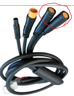

Does anyone know if these connectors are a generic type? Or are they proprietary to the motor. This is the cable harness that comes with the "Superhero package". The connectors highlighted are for brake and gear sensors.

Hi, i was able to plug a throttle designed for a bbs02 into my unit after installing the superhero pack.. i'm thinking that the other accessories might be compatible.

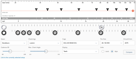

Well, i have some ride impressions from running the bike on an upright finally with dual chainring mode.
- Still limited to a max of 900w instead of the 1200w peak promised.
- The drive is quieter than stock @ 150 miles, so the prophecy of the gears getting quieter is true so far.
- Idler vibration under power is a lot less irritating when in dual chainring mode.
- Top speed on a 11t-32t rear cassette, 50T chainring with a 26" wheel on flat ground with vigorous pedaling is 28mph.
- These tiny 165mm cranks that come with the kit hurt my long legs after a short period of time, in addition to having significant radial/axial play. I can find some 170mm freewheeling cranks online, with an undesirably large offset, but i can't find 175mm freewheeling cranks ( what i need ). Possible that this is a dealbreaker for me.
- In dual chainring mode, your two chainring's tooth count should be 1:1. Lowering the tooth count on the motor drive chainring vs the bike drive chainring will lower the pedaling cadence. Increasing the tooth count on the motor drive chainring vs the bike drive will increase the cadence. If you were to say, run 60-72v to this thing via an external controller, the dual chainring mod would come in handy to counter adjust.
This seems slow and weak, even for 900W. By my calcs, 100 RPM pedaling your rig (what I would call brisk but not crazy) should get you ~32 MPH. I can easily hit 35 MPH on my bike with similar gearing with either Photon or TSDZ2. Well, the crank on mine is only 42t so it takes a little "brisker" pedaling for that. But the motors do it.

Here is a spreadsheet I made a year ago for the Lightest dual chain
wheels and other standard bikes to dimension the gearing to your liking.
Set your current or test gear data first.
No guaranties, check the result.

Re, the speed.. here's how my gearing would work out.. i have two things going against me:
1) Extra set of chain/gear drag
2) My legs put out ~75% of the power at 165mm.. part of that is the length.. the other part is not wanting to hurt.
FYI i have the legspan of someone 6'2" and i am 240lbs so ymmv
