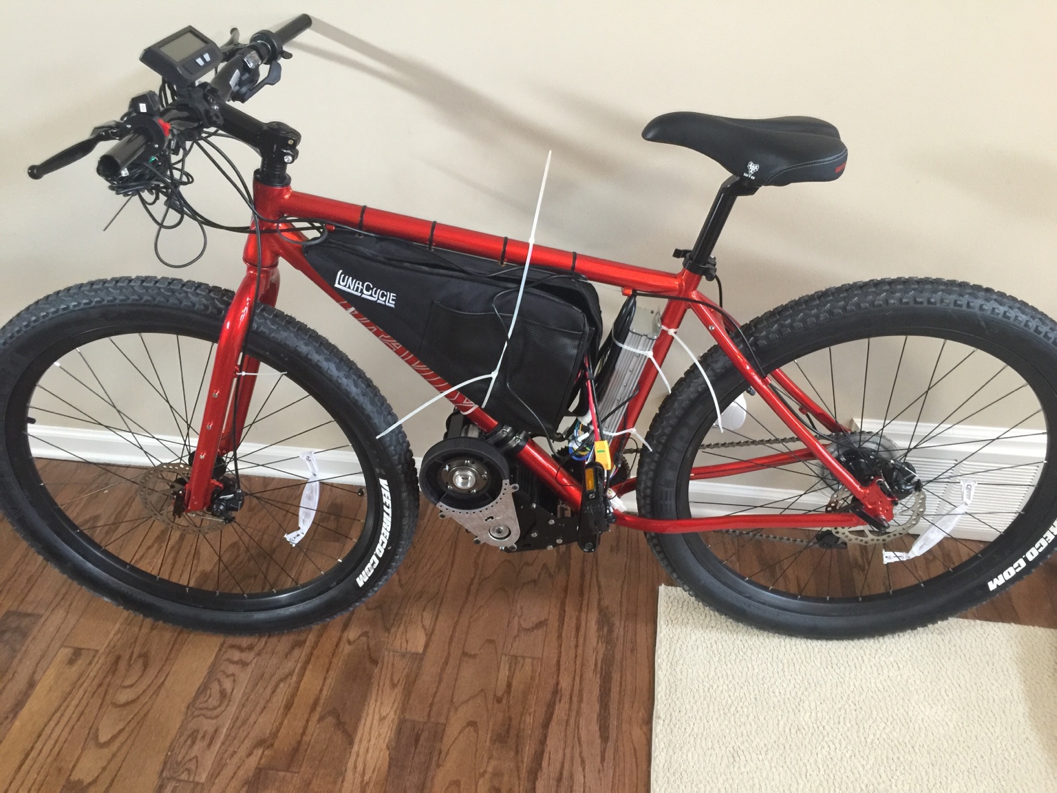

For most up to date details it takes some reading and searching of this thread. I read most of the posts and as a result I have a much better understanding of the kit and its ongoing evolution. When I went to do the physical install this past weekend it only took an hour and most of that was pulling the original cranks and bottom bracket. Just waiting to get my battery delivered and wire it all up.
Now having the big block kit in my hands I'm more impressed than I was just reading and looking at pictures. It's a serious pieces of machinery and absolutely beautiful in the eyes of the mechanically inclined.

It's alive! It is a total rats nest as I try to lay things out and develop a permanent mounting strategy for everything, but it's functional.
Biggest issue so far has been smoothing out and limiting the throttle so I don't cause the bike chain to jump. Also helps me maintain control of it. About 10 minutes into riding it I hit the throttle too hard from a dead stop and it damn near tossed me off.
Just amazing power. Bike drivetrain is definitely the limiting factor particularly with 31" diameter tires (29+ setup).
Nice one.
If you are running your throttle via the CA all will be fine once you dial in your up ramp settings.
The way mine is set up now is impossible to flip the bike even if I allowed it over 5kw. Without the CA I could easily flip it and have experienced the bucking horse which could also eat the drive train in less than a second.
