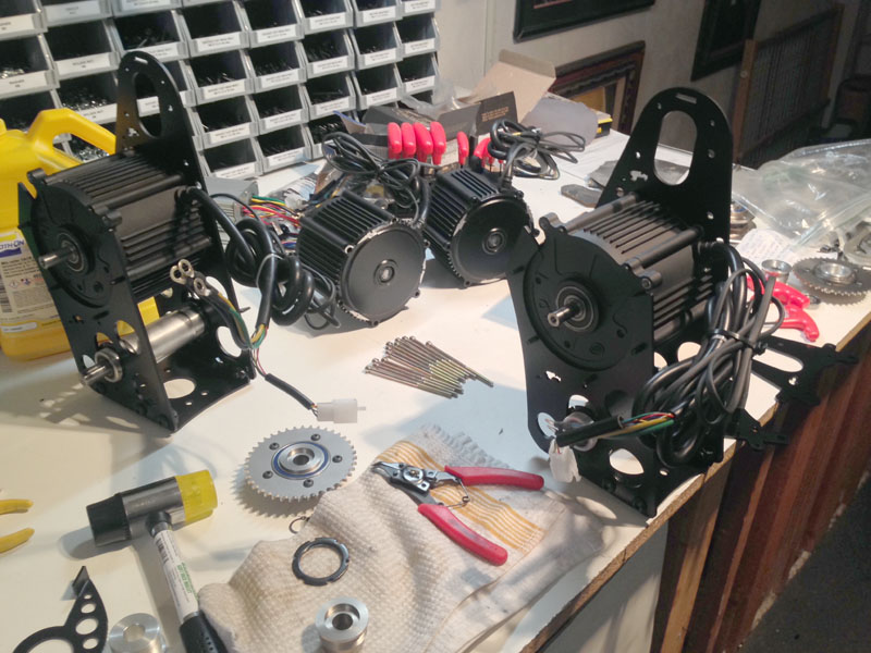

All of the major mechanical parts are done for all of the Luna orders that I have in. Laser cut metal, jackshaft housings and axles, 219 sprockets and chain, primary pulleys and belts and all of the adjusters and fiddly bits. I currently have 4 big blocks ready to install and four sets of everything painted and detailed. The rest of the motors have shipped air freight and will begin arriving by twos later this week.
I need to order the final drive freewheel sprocket and final drive cogs. These are easy to get off the shelf parts. I also need to cast the master pattern part for the urethane split block that is the upper hanger on the Luna drive. No hose clamps for this mid drive!
I am going to make safety guards for both the primary and secondary sides of these drives. I'm also going to incorporate a mount for a torque sensor on the chain from the chainwheel to the lower jackshaft. It's up to the first four whether they want to wait a week or so for the guards or have their mid drives shipped ASAP. Here are the first four:

I'll offer complete kits for both the 76R and Raptor 140. I think that the 140 kits will be big block only because of the weight of the bike and the width of the battery box. The big block motor is just wide enough to allow the drives to clear the battery box on both sides.
Because the 76R is designed to be lightweight I'm going to try to offer both big block and small block kits. We'll have to see how the small block fits the 76R frame.
I hadn't thought about offering a Cyclone motor version of my Qulbix kit. I guess if people want it...
Prices will be the same as my regular bottom bracket mid drives.
The first production run of Luna drives is coming together.
There's a teaser
