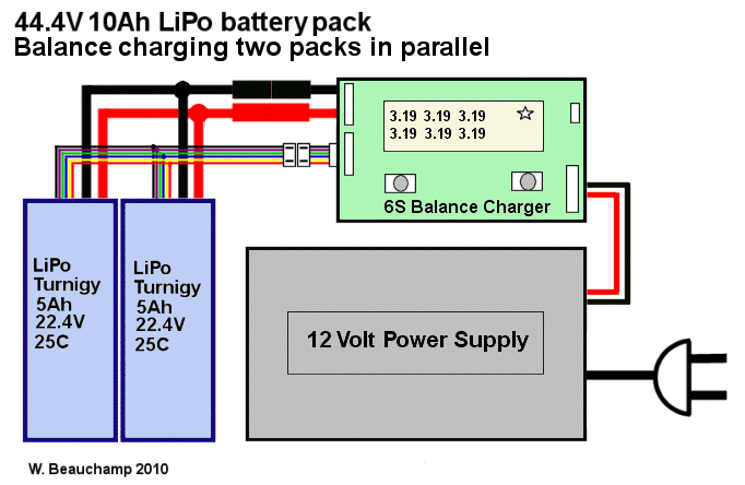

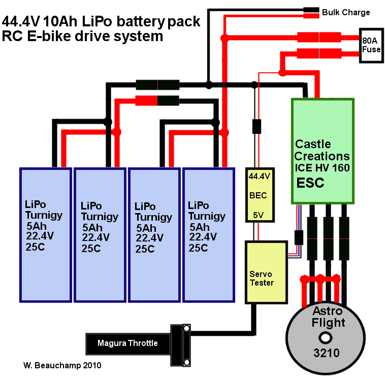

Hi everyone. Getting ready to switch to LIPO. I have seen hundreds of pics, read thousands of posts and trying to put it all together. If any of you LIPO users could post diagrams of your charge/discharge setups I would greatly appreciate it. Looking at pictures with a bunch of wires together can be a bit confusing. I find that diagrams can make it easier to visualize and understand. I know the basics, I just want to make it right. Thanks for your help!!!

Discharge
Balance charge
Bulk Charge
RC Drive Tutorial - http://recumbents.com/wisil/e-bent/rc_drive/tutorial.htm
