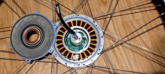

Could it be possible to get this motor to run:
This is a smaller (just a bit ;)) front motor from Sparta. No controller inside, just a motor. The funny thing is the magnet ring in the lid. The hall sensors work on this ring, not on the actual magnets that the stators/poles use :rolleyes:. Could it work with the current software; does "autodetect" find the right values to compensate for a difference (angle?) between both rings of magnets?
It's probably a SIN/COS encoder, which is much more precise than the UVW hall sensing type. If it uses just two hall sensors, then that's almost certainly what it is, in which case they will be analog sensors rather than digital.
For another example of this, take a look at my Powerchair BLDC motor thread around here somewhere (motor tech subforum, I think).
This one does work with 3 sensors. Most "Sparta ION" motors use this setup. Sensors are A20L. Unfortunately a sensor broke and I destroyed the sensor-pcb while desoldering a sensor :mad:.
I did read somewhere that these motors could be PMSM motors.
Given the A20L is a bipolar digital type, then the ring is probably just magnetized in a bipolar pattern that lets the controller know where the rotor magnets are relative ot the stator. It probably has the same number of poles as the rotor, but it could be different if the controller is custom made for that motor design to account for that.
You can test this by coutning the pulses from any one of the sensors. Also, you can verify if the sensors are all facing the same way, to know if it's 120 or 60 degree timing.
As for why they would do it this way (more expensive, more complicated, requires "calibration" to ensure alignment of ring to rotor magnets, etc), it's because halls near the stator (or in it) reading the rotor magnets have to deal with all the crap thrown out by the stator windings, and still try to provide a valid clean signal to the controller. Under high currents this doesn't always happen, and can be a problem during regen braking as well.
They do face the same way, I recon it is 120 degree.
The bigger rear wheel motors have 6 hall sensors by the way. (there is a controller inside)
Are most hall sensors bipolar in ebike motors? Could a A20L be replaced with a more common 41F (or a knock-off)?
