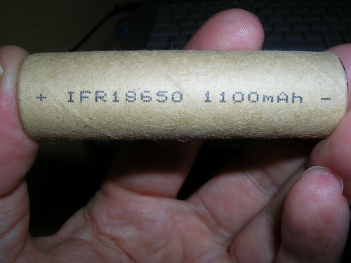

While we are on the subject, I chased down a sample from one of the people whom I feel is behind all of this and here is what I came up with:
and
and, for comparison sake, a genuine A123 M1 has been added, just to provide a visual aid.
But from my own experience, neither of those cells in the cardboard sleeve are identical to the ones in the CAMMY/VOLGOOD packs.
For what it is worth, I have weighed both of the batteries and come out with 38g and 82g for the 18650 and 2665 respectively.
That means a Cammy_CC 36v 20Ah would weigh, using the 18650 cells, around 7.6Kg and I know for a fact it weighs a lot more. I would like to know where they are getting their cells, they are obviously paying very little for them, by and by.
