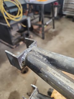

Began construction of the controller arms..... yes I know its overbuilt
limited time constraints keep more focus going. I got this one tacked up except the outboard side, and a second is getting real close to this same point. Sure its not the best choice of materials...but its what I had

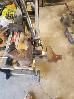

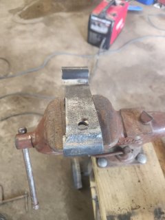

Im frugal to the point its sad.... (read low budget). Need bushings.... nothing off the shelf is a direct fit and cheap. Custom made..not horrible per piece.... at 6ish.... but still too rich for my blood....
Enter redneck engineering...
A few minutes with some tools.... and there we go. "Custom" nylon bushings, need pressed into big tube, light drag on inner tube.... and .60 cent each for a 1.25 inch bushing lol....
Im sorry....I did warn you I was an idiot

Found some time today to do some work. So I welded up the arms and made the outter pivot points. Still needs some tightening up before I weld on the upright mounts to the suspension arms. I know those welds arent the greatest, my fitment wasnt the best to be honest. Always feel like rushing. But heat zone looks good and probably going to do a few gusset as im paranoid. Feel free to chime in on suggestions or whatever
Well had surgery on Tuesday and in recovery. Managed to get out to the garage and do a bunch of cleaning and couldn't leave well enough alone. Welded upright cos onto the arms, cut the crush sleeves for all locations. Gonna post some updates here. Just need make the uprights and weld the spindles on. Things feel slow....I move slow and careful. Hoping by end of July to at least have it mobile under electric power.
Unfortunately due to an idiot move on my end, 1 of my control arms are around 1/8 shorter than the other 3, so im going to outboard that ones knuckle bolt to compensate for this error. Other than that... I guess we keep moving slowly

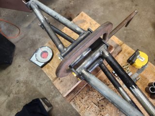

Oh yeah.... local idiot provides update. So got all 4 arms basically all welded up, made my bushing rolls and got them to fit and ready to build my uprights...and realized....my earlier jig wasnt as accurate as I had hoped. Figured out how im going to handle this and will update the process soon, but here are some pictures on the way. Also, personal amusement here, the front suspension design is heavier than the rest of the framework, just kind of funny to me.
As you can see in the top picture i welded 2 little temporary braces to hold tje arms parallel while designing the uprights, and then realized the issue. Fortunately my design allows me to step back and move ahead well. Im going to disassemble the center section and use it as a jig for both left and right side upright design. Doing it this way will allow absolute consistency in vetical alignment of all suspension joints, allow for setting up the rest of the knuckles/steering, and holding it all in alignment. Then i can use the fabricated uprights and cut off the outter c sections of the arm and align them using the fabricated uprights to make sure all is in proper alignment to each other and reweld them.... progress is progress i suppose
I also realize the welded areas are not 100% covered and had planned to finish it all once i knew it worked.... guess that also worked out for me

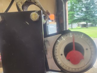

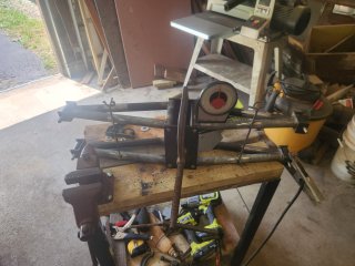

And here we go. Knowing my mistakes from prior, it was time to work ahead thinking. I knew if I built the right/knuckles. Then I can refit the arms properly. First think to do was to lock all the upright pivots into the main center body so they were perfectly spaced for final assembly. Then I needed to know my angle necessary for scrub.
For scrub incline, I took a drywall square and put zip ties where the center of tire would sit, and the axle height, one on each leg. Then made the square level and plumb, connected between the 2 points and viola, necessary camber for proper scrub. Doing it this was was indicating 12*.... so i ran with it
Easy peasy.... now to transfer it to the uprights in their jig

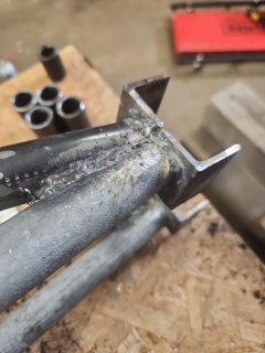

And set tack welds while hoping to not melt the nylon bushings toooo much
All good. Second side was much more difficult than side 1 for some reason to get it to be stable. From here, we punch out the bushings/crush sleeves and weld solid and wait to cool.
And at last.... front knuckles all welded. Axles welded, tires on. And i can see how she sits! 2 days of work to get here... man im tired haha
