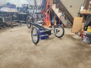

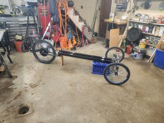

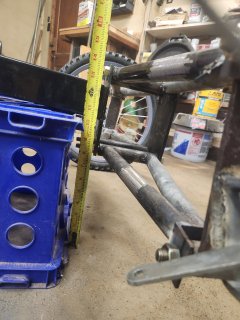

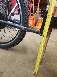

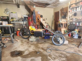

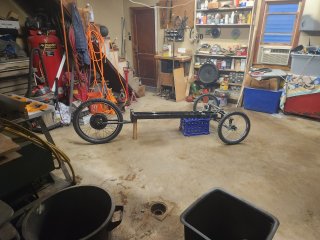

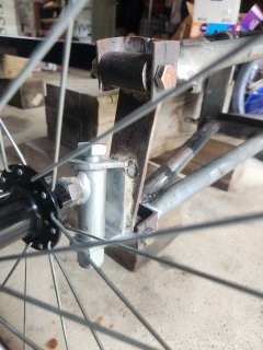

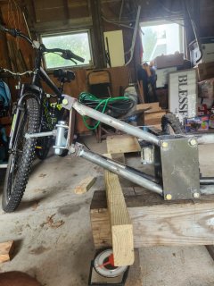

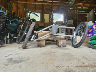

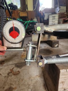

Tonight I was able to take an hour or so and realized I was probably going to need to do some adjustments as discussed in the prior post. I cut a plate to keep the uprights upright and at the proper distance and assembled the front end. I was pretty discouraged when my one side was off camber about 6*. Upon doing some thinking o decided rather than make adjjustments, I could potentially swap one of the arms to another in the chance one may have been a hair longer than the other or who knows. Swapped that sides upper and lower arm and bang on with my jig angles. Gonna be honest....im pretty excited at this point. Still need to true the one wheel. Install brakes and steering but couldn't resist another mockup shot for myself. The right wheel in the picture is not dead straight. I checked my axles and they are <1* off level when the whole.assembly is level.... im very happy with that. Hope it helps my vision make sense.
P.s. please dont mind everything in the background, due to circumstances there are 3 people's worth of stuff in the garage so space is at premium.
