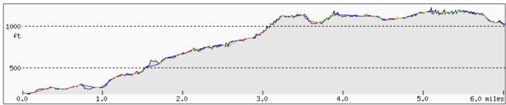

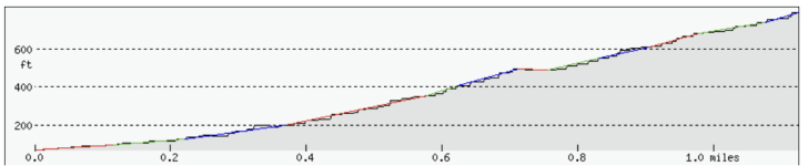

Quite heavy, around 150 kg, with bike, gear, batteries and all. The motor is a knockoff G062 6T, I rewound it with 220C wire to handle all that extra load. I get pretty tired of pedaling up the hill every 20 minutes, so 20 minutes on, 5 minutes off, repeat.
I am not sure I understand--you go down the hill then right back up the same hill immediately? At what speed? (the speed, weight, and slope are all needed to find out how much power it takes to do the job).

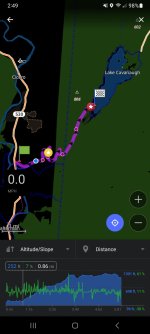

At points the road is up to 70% grade, at which I hop off the bike and walk while it pushes itself.

If I simulate even a 50% grade with a 48v phaserunner (closest to VESC), and a different bafang geared hub (didnt' see yours in the list), I get essentially no progress uphill at all, and rapid overheat of the system. I'm pretty sure the numbers below the graph are wrong, "blown" by the situation placed upon the components.
