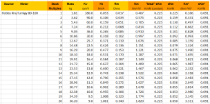

I did a basic exercise in Excel based on the Turnigy 80-100 motor with multiples of stack length from 1 to 20 with the Kv, Kt and Rm scaled proportionatly. Mass was also scaled by simple multiple, although I accept this isn't entirely realistic.
"Ideal" Km is simply Km for 1 x stack length kept constant.
Of the results some are linear, some non-linear, but all progressively diverge from ideal except for sKm^2 (but not Km^2).
Hope this might be of some interest. I have a feeling I should repeat the exercise for motors in parallel (so the weight multiplier is accurate), but I suspect the answers will be the same.
your cals seem to be ok. i dont get what ideal Km shall be good for?
we replaced sKm by sKm² in his spreadsheet since this is more useful for comparison. Km² with the unit [Nm] and sKm² with the unit [Nm/kg]

Obviously, the motor constant won't be the same, either as Km or Km². That's why we divide by mass. Dividing by mass and using the "idealised" figures that PunxOr did, sKm² is indeed constant.
You shouldn't necessarily expect the same sKm² figures for your two motors because larger motors have something of an advantage, as I said. There could be other reasons, too. Differences in non essential mass, that you mentioned; inaccuracies of measurement etc.
It seems to work as expected. The results reflect the measurements you took...
Sorry, that "ideal" Km was a mistake. It should have been sKm, showing how sKm *should* remain constant as the stack is lengthened (or motors put in parallel).
I will correct it.

Data and graph updated in previous post. I also tried it with motors wired in parallel and the results are identical. If nothing else I now finally understand what's previously been said ;)
