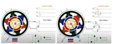

flute2k3@hotmail.com said:
the accurate position shall be the center of between the "entering" and "leaving" of the hall sensor.
?! my philosophy is different. I always look at the transition from one hallstate to the next. With this I always have the exact rotorposition and the spinning direction. In this example: if you enter sector 6 clockwise, you are at 60 deg, if you enter sector 6 anticlockwise, you are at 120 deg. So I always take the old and the new hallstate to get the exact rotor position.
Code:
ui8_hall_case=ui8_hall_state_old*10+ui8_hall_state;
//6 cases for forward direction
		case 64:
			q31_rotorposition_hall = Hall_64;
//6 cases for reverse direction
		case 46:
regards
stancecoke

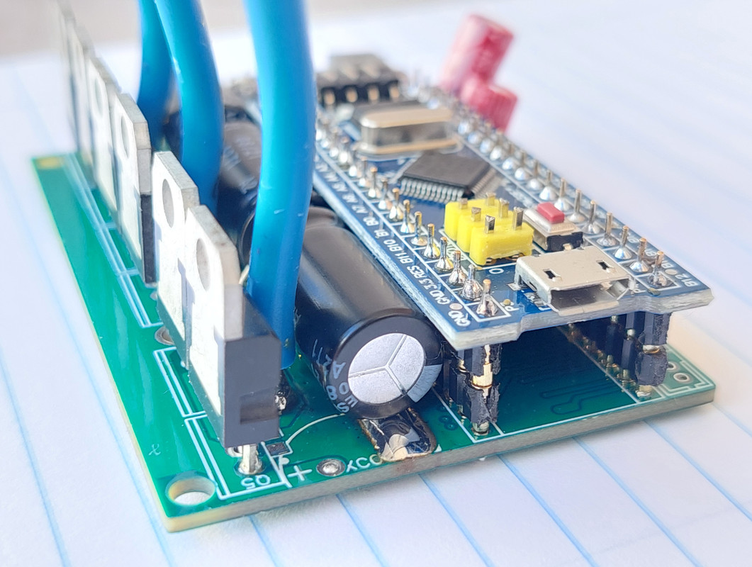

Just built one of these (casainho sent me r1 board)
Seems to switch nicely at very preliminary glance and is pretty small. Fsesc75100 for scale.
I need to go to sleep so hopefully tomorrow we get some spinny spinny.

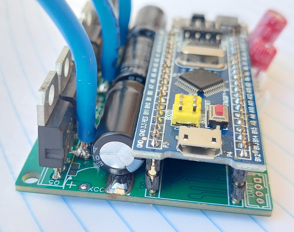

the board looks really nice and neat!
maybe you can try my comparison and verify the current consumption @ same rpm.

Thanks. I was pretty pleased with how well it went together. I haven't soldered 0805 for ages, it's so easy I could do it with a lighter.
Main problem is there is not quite enough room for caps but i think badgineer is fixing this for the next version.
You mean with the hall sensor angle tests? I'm not even going to solder the hall input resistors on. I'm running it sensorless.
I don't really need to repeat your measurements regarding the hall sensors, it's kinda obvious that if they're offset by many degrees it's going to be less efficient. You just need to get them right by whatever means.

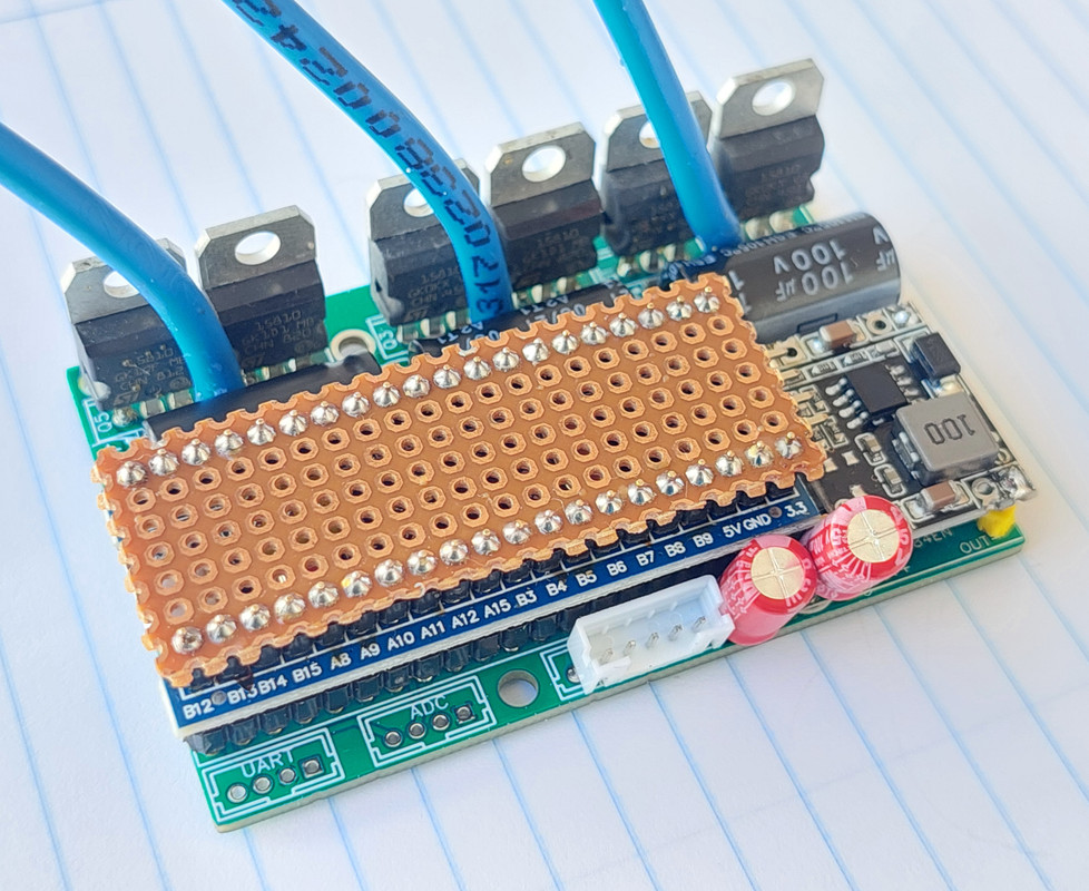

Built, running MESC FOC firmware on F401CC black pill board.
[youtube]qFH7duzY3uM[/youtube]
https://youtu.be/qFH7duzY3uM

Parts list:
Magnachip MDP10N027 MOSFETs from Aliexpress
On Semi NCP5106 gate drivers I had left over
On Semi NCS20034 opamp from RS I had left over
1mohm shunts from Aliexpress
only 2x150uF capacitors (way too low, needs about 2x as much minimum)
3x 4.7uF 100V ceramics from Aliexpress.
Left over 12-5V DCDC I bought years ago and found in a drawer
Blackpill F401CC from Aliexpress
No heatsink atall so far. Need to get out the drill and blocks of aluminium. Got a case on it's way...
Firmware running is true FOC at 20kHz PWM. 2500rads-1 current bandwidth, 22V input (the motor really does not want much more than this with this PSU)
Nice little performer, and really really easy to build.
Only needs some bigger caps and perhaps phase voltage sensing and it would be perfect. Quite pleased with it.
Draws 0.4W standstill.

@stancecoke, what I mean is the 𝜃 used in park/clarke transformation. the measured d axis timing tc is in the center point of of t1 and t2 slot. but later on I realized you use PLL to lock the angle after start up so there shall be no issue.
mxlemming said:
stancecoke said:
mxlemming said:
Stator resistance and inductance should be used to tune the PI loop for the current controller
I always tune the PI parameters by trial and error, not by the mathematical/physical theory :D
mxlemming said:
it will be much less accurate since it relies on single point detection
Yes that's right, the autodetct routine could be improved a lot, but the accuracy is sufficient at the moment, so I'm not motivated to that :wink:
mxlemming said:
That gives you the centre angle of each hall sensor.
So you have to add/substract 30 deg in the hallsensor interrupt to get the real rotor position, depending on the rotor rotation direction ?!
regards
stancecoke

Here are the images of fully assembled last version (v0.5_2022-03-19). Well, is missing / yet to be assembled, the battery wires as also the BIG capacitor on the battery wires.
The board needs to be a slightly larger to have more room for the hall sensor connectors / red capacitors and that 3 big capacitors.
The board was not yet tested, I will test it probably on next days:
