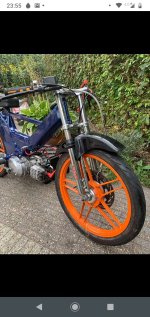

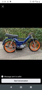

Here are some photos of the motorcycle when i bought it. Some photos have the motor assembled but i bought it without the engine.
