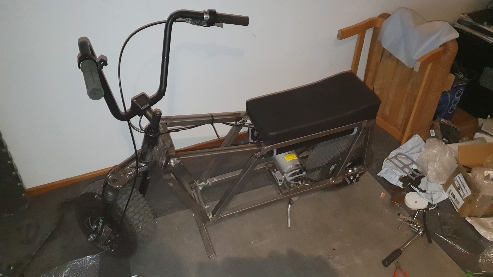

DIY (Mini) ebike/moped -> square tube frame, hoverboard motors - does this look reasonable? Any obvious oversights?
The main problem isn't the thickness of the arms, it's stress risers which exist just about anywhere a sharp change in angle exists in a structure that flexes.
That's what breaks shafts and axles with circlip grooves, for instance. Even a tiny cyclic flexure induces stress at those points because taht's where the thing stops flexing, instead transferring the energy change (terminology?) to the material at that point.
If it doesn't break within the useful lifetime of the device it's part of, it doesn't. matter... :)
Thats why i made that area thicker/stiffer, so flex wouldnt just be happening down by the hub, where there is the most leverage, but rather spread out along the length of the arm.

Bizarre it needs a chain tensioner IMO. That motor bolts down, which means you should be able to unbolt it, size the chain perfectly, then bolt down again. Worst case might need a half link.
Not really since the sprocket was very cheap and the fastener holes are drilled just a little off center :p
The fillet
I do get that why doing fillets is a good idea, yes ;)

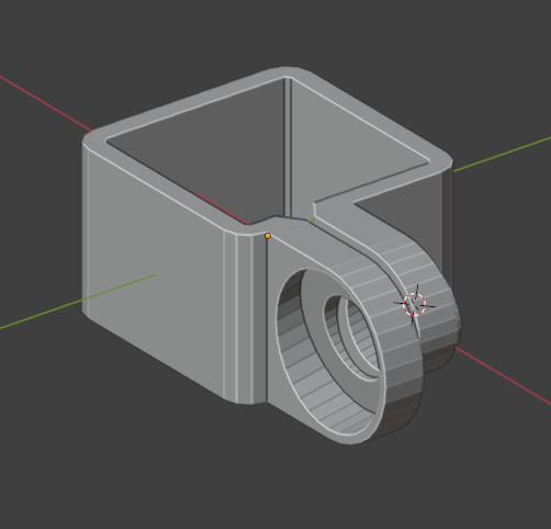

Knocked together a very simple mount of the large LEDs i picked up for front/rear lights, this one is intended for the rear.
The LEDs have a threaded tube and a nut to hold it, the mount is a clamp design which will utilize that nut to hold it to the frame rail.
Its angled so it will be horizontal when attached to the rearmost tuve on the left side, gonna give it a print and see if i like it, if not ill do something else.
Not sure if this would work up front, im gonna look at it some more after work.
How are you going to get it over the frame tube?
Im hoping its going to be flexible enough to just force it apart ove the tube.
The section through which the LED tube goes has a cut all the way throught which will be held closed, in clamping action, by the nut.
There are special infills that are flexible in one direction but stiff in the other, such as crosses. It would be a good choice for such an element.
There is very little infill in this part and none where it needs to flex, as it is mostly "wall" in 3d slicer terms.
As for flexible infill, that feels a lot like hype to me, except i very special cases.
Most of print strength is in tops/bottoms/walls of a print, most of what infill does is to be something to put the top on.
It did flex enough :)

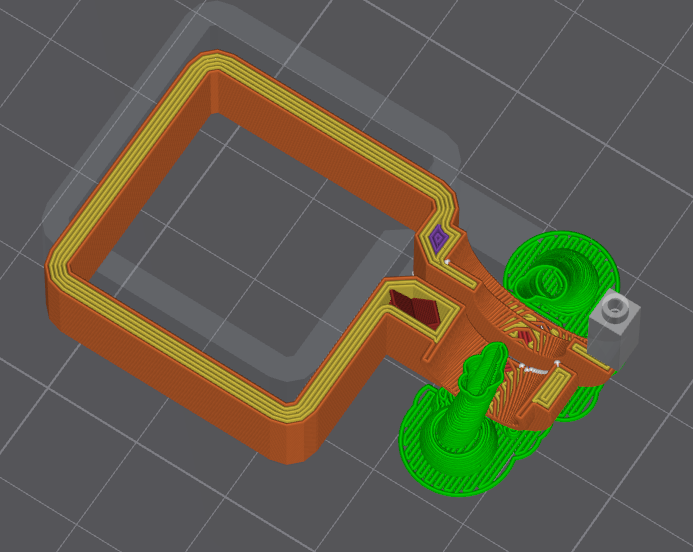

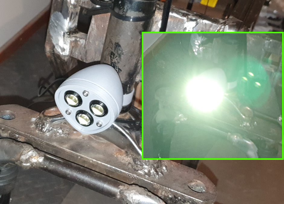

The design for the headlight is done and on the printer, its a simple clamp around the headtube, exit on the back for wires.

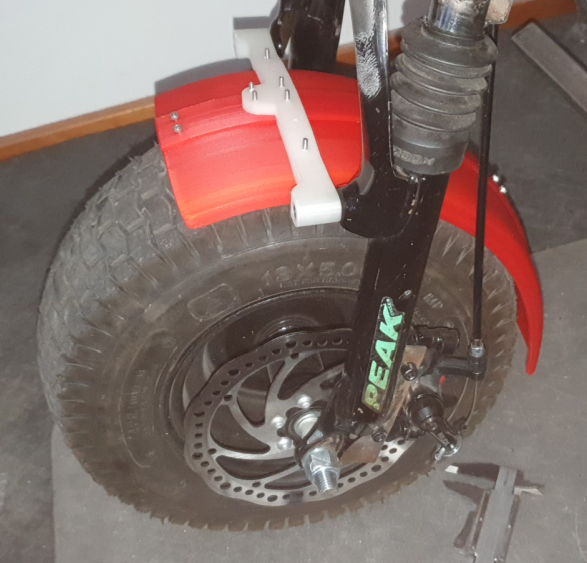

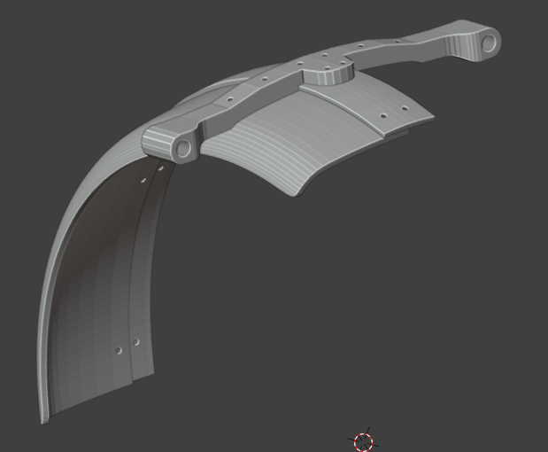

Having a go at making a front fender that will attach to the v-brake posts.
The main part of the fender is split in two down its length for ease of printing and replaceability if a side gets damaged, joined in the middle using an overlapping part and then screwed into the v-post mount.
Dont have any black filament, which i wanted for the mount and the store was out when i visited on friday, so it will get sprayed eventually.
Need to get some correct length screws but otherwise im pretty happy with it.
Going to whip up a rear fender based on this one, its going to be slightly longer with a small upsweep at the back and i might split it differently.
