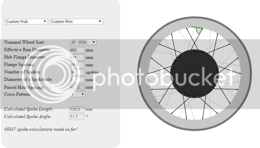

Can anyone who has their motors, or even laced them; confirm these are the correct measurements.
arkmundi said:
Looking for the correct specs for "Hub Flange Diameter" and the "Flange Spacing" numbers for calculating spoke length. Believe its Hub Flange Diameter: 231 mm; Flange Spacing: 49.5 mm; Diameter of a Spokehole: 3 mm. For the USA Group Buy for MXUS 3000W Hub Motor which I signed onto. Also, motor centers on the rim, so no dishing, right? Thanks. :mrgreen:
I'm currently looking at ordering these sized spokes for the JRH 19" Moto rims.
That look right!
