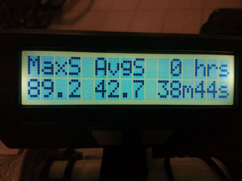

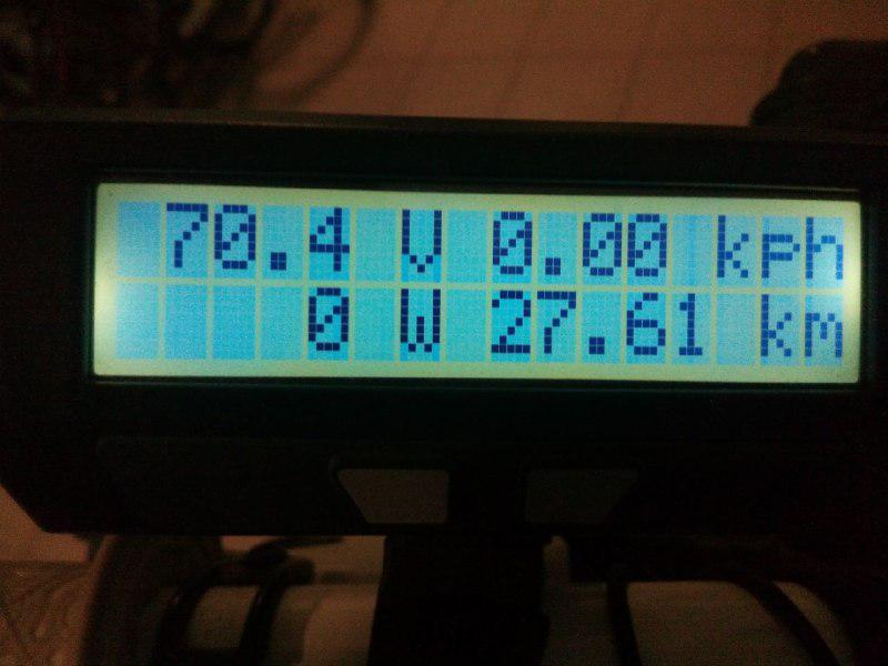

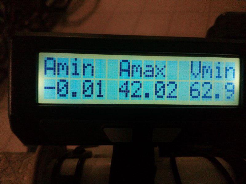

Managed to do some riding today. Used the road for motor testing. It has 2 artificial humps where I need to slow down to 30kmh and enough space to accelerate to 60-65kmh, then again slowing down. So the ride looks like: acc to 60-65 - brake to 30 - acc to 60-65 - brake to 30 - acc to 60-65 - brake to 10 - turn 180 degrees - acc to 60-65 - brake to 30 - ..... non stop till 14Ah from the 21s LiNMC battery was drained. Such ride easily overheat the motor if the power is too high. I used new sine wave controller with 40A battery current. The power was 3400W in the beginning and 2600W in the end. Outside temperature was +5 Celsius. The motor had +25C in the beginning and the maximum temperature I got in the end was +110C. I thought that I will overheat it much faster. Some screens from the CA behind the spoiler. CA shows about 5% higher current. 89kmh on the CA is no load test with 84V.
Changed the controller current to 60A and will ride again soon. The heavy rain started and I don't think water cooling is a fair advantage. :)
much more important than battery current: what was the phase current?
If the motor is rated to 3000W at 72V (i think it is?) it would mean with about 42A phase we can ride all day long and it will never overheat. sure nobody will use such a conservative setting, but i just wanted to mention it because many here do think if a motor is rated to 3kw, it is 3kw from the battery which is not true. its 3kw at rated phase voltage.
The controller does not limit the phase current. As I see on the wattmeter it takes full power from the battery from the start.
