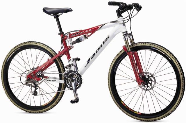

Rack for the FS: What about folding the rack rear supports more forward so they can attach to the seat tube instead of the seat stays? Wouldn't be as stable, but maybe enough? (something like this:)

Bought one of walmart's mongoose xr pro mountain bike. It's an online only thing. Was building it and gave it to my brother, I liked riding it. Can't ride up right very long and got into my trike. May get another to do short rides to the store. Full suspension is very nice after a hard tail but no battery room. Would need a custom battery.
There's a thread on FS bikes with plenty of space for batteries, but most (all?) are several years old (like GT I-Drives). Of course any model with URT would be a candidate.
This is the space I have to work with, better than some FS bikes, but less than some of the older Trek and Giant FS models:
I think I can get three of these 12Ah lipos, in series, in the triangle to get to 60V:
