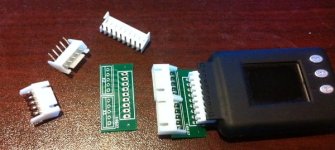

I made up some simple adapters for my 4s hardpacks for cellogs.
I liked the big cellog board from the canadian porsche project, but wanted something smaller since I'm still playing with form factors.
Comments are welcome. If/when I make a full batch, I'm going to make the drill mount holes bigger (oops - I designed these at the kitchen table at the inlaws) and make the jst mounts full pad size so they can be used for wire mounts for custom harnesses.
I didn't solder the pictured one yet. I had to use pliers to insert the jst connectors, but they fit.
If there is interest, I can kit these up really cheap since the pcb itself is small. Note the space between the celllog connector and the pcb. That's needed with this version unless the black shroud on the cellog is trimmed.
Thoughts?
These are not for sale now, but I'll get a batch made if there's enough interest. I can kit these with connectors for like $5 each and probably go 4 for $15. (That's just a quick approximate price)
