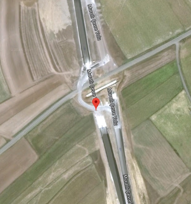

What an unsettling place to end the day. The final tracking data for today leaves them here (not much around):
This section of road (Muratlı Çevre Yolu) is very much a new work in progress - not sure how old this satellite image is, but if there's still no bridge there, it could be hard on the trike. Hoping there's no reason to be worried. :(
Well! If nothing else, this had me scratching my head a bit and ultimately updating to the latest version of Google Earth Pro (thanks, solarEbike - a picture is worth a thousand words). Nice though the new road looks, it's an odd place for the tracking to stop for the day. :(
Perhaps a few words would have been helpful here.
The buttons indicated below turn Historical Imagery on and off. Try fiddling with those settings if you're not seeing the imagery you expect to see. In particular, try turning this feature on and off. If you're still not seeing the new image then it's likely that it's so new that Google is still in the process of rolling these out to all of their servers. It can take a while for everyone everywhere to see the newer images when they roll out an imagery update. I can't see the newest image when I have the Historical Imagery window open but if I check back in a few days or few weeks, it will be there. The version of Google Earth used shouldn't have any affect on the imagery you see unless perhaps you're using a really old version.
My guess is that this is not where they've stopped for the night since their last known speed was 24 kph and the last tracking point was at 7:30 PM local time and they've usually been stopping for the day closer to 9 PM. Their stated destination for tonight was Tekirdağ 30 km away so it seems feasible they made it there and the tracking data just isn't keeping up for some reason.
Maybe the Spot device has a low battery? JLE mentioned lack of USB ports and they just got 2 more in their last care package. The satellite network could be down but there appear to be updates past that last timestamp from others. This assumes that the Sat-View platform is correctly accounting for time zone differences. Or perhaps they've been abducted by aliens and will mysteriously re-appear many km from their last known location with no knowledge of how they got there. The most complicated explanation is usually the correct one, right?
UPDATE: So it looks like they camped by the side of the road in a field 4 km (10 minutes) down the road from this spot. Maybe they set up camp and noticed that the Spot device needed charging and plugged it in and it started broadcasting again? I plan to use an inReach device for my trip but I don't plan to broadcast the locations of such campsites until after I've left the location.
