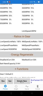

Thats good...what percentage values did you put for the RPMs??
When I put in 100, it automatically updated the rpm. They all show 9000 on my app. As J bjork mentioned earlier I probably didn't set up throttle wires correctly and so was on middle setting. So when I made them all 100% setting it overode that. But you may have set up throttle correctly and it might not make a difference.
Ok I see...which fields does it show 9000 on your app? Thx
Here is a screenshot of it.
