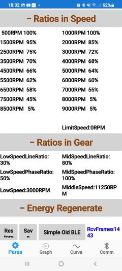

Does anyone know what "LimitSpeed" does? It doesn't seem to limit any speed
It definitely does limit speed; I've used it to do so. However, the RPM for a hub motor is off by a factor of 4. I posted a comment earlier in this thread detailing how to use this parameter to limit your top speed.
Edit: at least I think it did. Might have been on another forum
Right, so if I'm remembering correctly, you basically put your tire diameter and the desired speed into this calculator.
https://www.omnicalculator.com/everyday-life/rpm
It will give you the corresponding RPM. If you're using a hub motor use the tire RPM result, but multiply it by (probably) 4 to compensate for the fact that the app is kind of built to expect a mid-drive motor, and enter the result in the parameter. There's
more about pole pairs in the adjustment instructions PDF that can be found at the Google drive link shared several times here

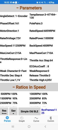

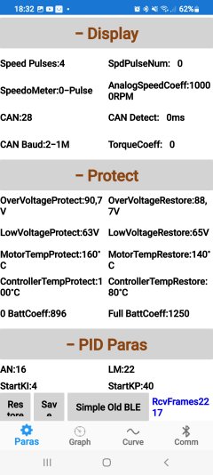

hello guys i need some help as i said
I'm attaching everything I have now
I would like to go 10km/h faster
and activate reverse
thank you all
thank you all
Regarding top speed: your max speed setting is high enough that is almost certainly physics that's setting your top speed, not the controller. For example, my 12kW motor pushed by a 72V battery with an 86kg rider on a 24°c day has a top speed of around 153kph. But when I weighed 95kg on a 15°c day, my top speed was only 138kph.
the problem that does not go beyond 115 km per hour
forgive me what is the parameter to increase ?
Thank you
thank you all
That sure was a pain in the butt to read on a big screen, these images are way too big! :lol:
I think you did not enable flux weakening, which is named "WeakResponse".
Usually enabling flux weakening helps a lot with top speed, so try this first.
hello and thanks for the help
I tried to change that parameter but nothing
Reverse gear also doesn't work
I'm afraid it's the firmware blocked by the parent company
I'll have to find a new firmware
I doubt its firmware issue.
For field weakening to work have to you tried 1,2,3 modes? Are modes activated? There is eco and sport modes. Have you tried to change, set sport mode. Sport and eco probably it is more to do with throttle response or amps ramp up.
For reverse you need to short two wires. There is dedicated plug/connector coming out of controller.

guys i hope someone could help me, i tried to run the fardriver software on the pc, i usualy use the phone with bluetooth, i managed to connect it but it doesn't let me adjust the overvoltage neither the restore voltage , it's grey so i can't click, while it does let me adjust some other settings, might be a silly question, but i tried for a long time and i can't change it. thanks guys
