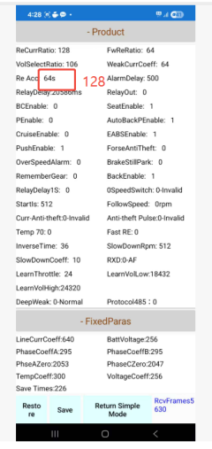

I recently received a 961000B controller with an encoder. I encountered a problem: the throttle response is very slow when reversing. Even with the throttle fully open, it takes 3 or 4 seconds for the car to start moving. This is very annoying. Does anyone know how to speed up the response? I've adjusted the reverse gear RPM, but it doesn't help.

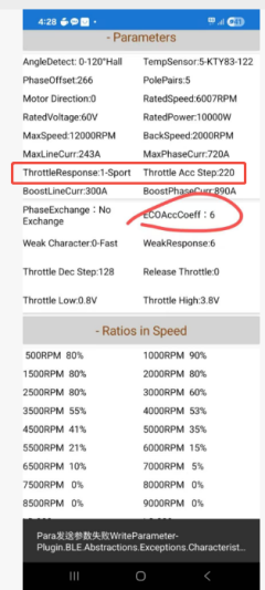

Hello, pls try to set following data and see if it works
1. Re Acc 64s revise to 128
2. ThrottleResponse choose Sport option
3. Throttle Acc Step choose 220
4. ECOAccCoeff revise to 6.
See below pictures.

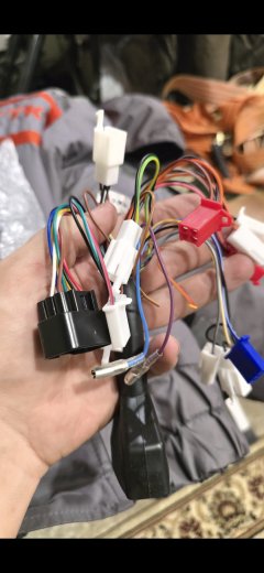

Thank you, the problem was solved by increasing the reverse speed to 2300. If I set it to 2000, the problem returns. It looks like this is a software bug that needs to be fixed. I also had a new problem: I couldn't find the connector for the cruise control wire. Did the manufacturer remove them? I have the version with an encoder.

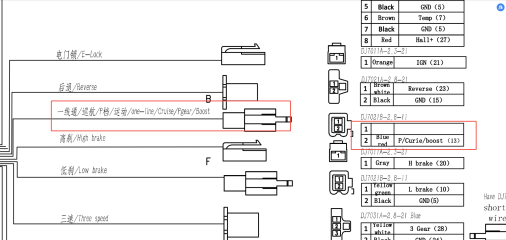

For your ND961000B encoder version controller, the one-line/cruise/P gear/Boost functions are all in the blue red wire. See below diagram definition for your ref. Thanks to check if it correct.
Unfortunately, I don't have such a connector, it's missing.

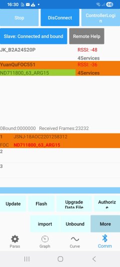

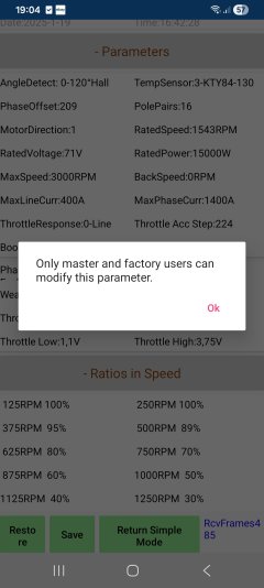

How do I get rid of this damned
"Slave: connected and bound"
I can't change the values I want anymore. This appeared after an App Update.
Best guess is the new app isn't compatible with the firmware on your controller. That has happened with other devices before. (don't know if it has with this app / controller combo).
If you can't downgrade the app, you could try looking for it's apk at the various apk archives around the web. Unfortunately there is not yet a Fardriver archive thread like this votol one.
I already tried to downgrade the app, but the problems are the same, I can't change currents or anything important.
They downgraded me to a "slave". 😉

The problem was resolved remotely by the manufacturer. As far as I understand, this is due to the fact that two accounts were linked to the controller, but they did not have the same control rights. As a result, both were deleted and a new account with administrator rights was created.

You can write to the original owner and ask them to remove the controller binding from their app.
when you get to this popup again, just unplug and re-plug the hall sensor connector 20+ times. After it senses 20 cycles of unplugging and plugging back in, it will start a force unbind with a popup asking if you want to unbind the controller from all devices. Select Unbind. Then simply make a change to a setting, and it will throw another popup saying you don't have permission to make changes unless you bind, and will ask if you want to bind. Click Bind. [new popup] Click Bound. [new popup] Click OK.
Done. Bound. You're now the master, no longer the slave.
If it goes into a countdown, just wait for it to count down, or try unplugging and re-plugging the hall sensor to speed up the countdown. Once the countdown ends, it'll automatically unbind from all devices.

Well it's the only way to do it. And it works 100% of the time. The key is that you need to be connected to the controller with the app when you do it. And you want to hear the controller beep once when you first unplug it, then just keep unplugging and plugging back in. Once it detects 20 cycles from the first disconnect beep, it'll give the option to force unbind. And technically it only has to sense a disconnect on the power wire to the hall sensor. So if your sensor is hardwired, just cut the power wire and strip the ends, twist the ends together, power everything up, make sure you're connected, then disconnect the wires til you hear a beep, then touch them together for 1 second, remove for 1 second, touch for 1 second, remove for 1 second... 20+ times. It will work.
Hi Vito
Could you please specify which pins are suitable for reprogramming (repining) for functions such as boost, parking, cruise? I spent 2 days and didn't find a clear answer, only questions from other people
My Fardriver is ND72450ALH85 (new one/gen2)
For Cruise function PIN17 🔵🔴 (cruise/parking) is suitable obviously since this is indicated in the pinout. I assume PIN18 🟤 (one-line/boost/alarm?) is also suitable for functions? What about the other pins?
