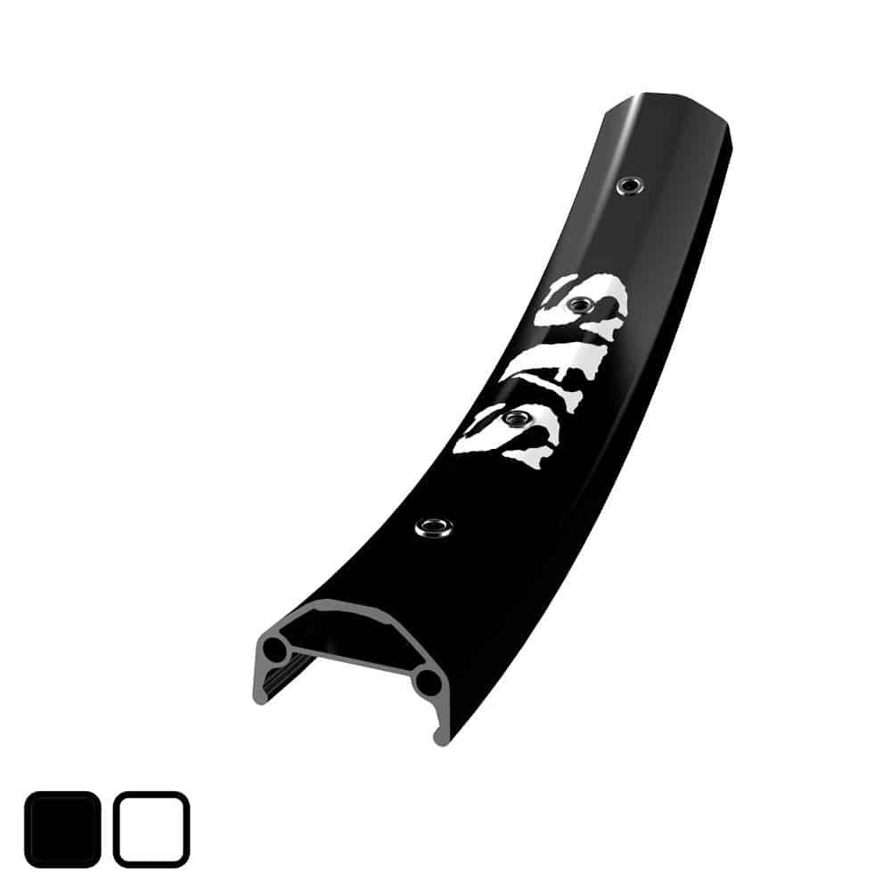

If you can find the right sizes. I used Sapim E-Strong Single Butted spokes and nipples and a Halo SAS rim, so it was a little under $200 for the combo. I was lucky that the left and right side spokes calculated to less than a millimeter difference, so I was able to order the same length for both sides.

One of the strongest rims you can get
Your motor laced into a 27.5 Halo rim
A couple more builds using the same rim, but different sizes. The wheel building tips in the threads are worth reading.'

I wouldn't lace more than single cross. If I had it to do again, I would go with straight 14 gauge spokes with washers; lesson learned.
