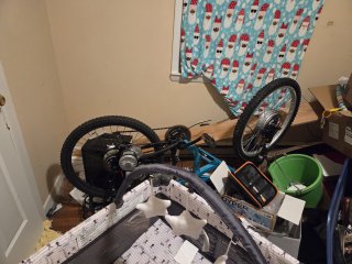

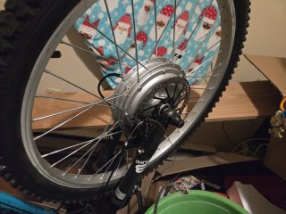

But i can send picks of the hub and chain driven on the rear not anything fancy this is a prea bud to make shure I can get logic and everything I need to make a bigger e dirtbike later with same set up and kind of a look what I can do type of thing give me a few ill drop the picks in
Ignore the mess iv had to keep my daughter in the work room she been clingy cuz she sic but like I said nothing fancy

Wish you used punctuation and line breaks when you typed :O
This looks like a geared motor, a DD hub would usually be bigger.
You can tell for sure because when spinning the wheel with your hand, one direction spins freely, the other has lots of resistance.

If it's a geared motor, which given your earlier description, seemed highly likely, then I'd just follow neptronix advice. However, based on your description above, your motor won't be subject to high torque off the line, since your control logic doesn't start the front motor until 10mph, so you might be able to push it a bit. However, looking at your pics, it's doesn't look like your typical geared hub either. Sort of shaped like a mini direct drive. Anyway, if you would be willing to open the motor, that would solve that riddle, and if it actually is direct drive,, then the cooling options are available (statorade, hub sinks).
