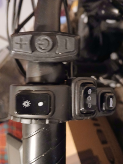

I have got myself a brand new UrLife T5 bike.
This is what it looks like.
I have been able to get the speed up to 46Kph, about 28Mph just by holding the Brake and throttle on and power up. hold for 8 seconds and hay presto, but thats all I can do.
I have tried to get UrLife to give instructions on how to change the Speedometer from Kph to Mph, but like all Chinese based companies they do not want to help once you ask for it.
There does not seem to be a P code which most people seem to talk about as holding both + & - at the same time does not work. Even their manual does not tell you much, it tells you how to reset the Milage, but this just does not work.
Does anybody out there have any experience with the UrLife T5 Model and how to get into its P codes or how to change the milometer from Kph to Mph.
All Positive help is apricated
I live in the UK and require the unlocks for it to be legal on the road.
I do not mind none positive reactions to this. I expect not to get any real feedback for this bike as its a copy of other bikes that are already on the market.
I know those bikes have different controllers which can be cracked, I am just hoping somebody out there knows the controller on this bike and knows how to open it up just so I can change settings even if its just KPH to MPH

Try the holding + and - buttons immediately after power up on the display, That seems to be the universal setup on most displays with a timeout so you cannot do it later,
If that doesn't work, there's also plus and center, and then minus and center,
Some bikes use double tap center button.
Thanks for the replies but neither of these work on this bike. The only thing that works is throttle + front brake + turn on and hold for 8 seconds. this increases speed.
This is the display I have.
I found a video for this bike which explains how to change the Odometer from KPH to MPH. It is not a P Code change its actually a hard wire change.
If you live in Europe they disconnect a connector, if you live in the UK you have to connect the connector. And guess where the connector is, yes you guessed it, its part of the controllers wiring.
I suspect they have hard wired the controller so you have to disable it there, cut wires or disconnect a plug.
