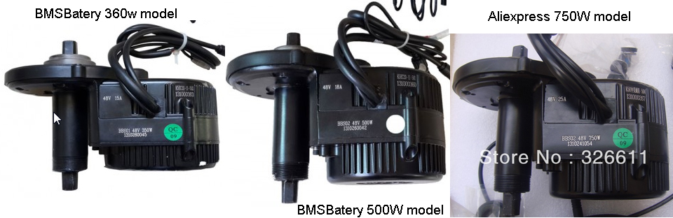

Quick question - and sorry if it has been covered already.. I haven't read every page.
But BMSbattery is selling a BBS02 model rated for 500W.
http://www.bmsbattery.com/central-motor/636-48v350w-bbs01-bafang-central-motor.html
Total cost delivered to my door is about $500 ( they don't seem to be gouging on shipping for this item ). That's a decent price.
The question is - does the 500W model really have the wider stator? or just the wider casing?
If so, it would be a good candidate for running with an external controller, which would remove some of the heat from inside the case, allowing you to push it like mwkeefer did & also save a few bucks in the process over the 750w model..

He is answering a question about the 350w unit, which looks like the smaller stator version.
There is no mention of the 500w unit any where near that post that i see.
My question is whether or not the 500w unit has the same stator as the 750w model or not. If it does, it would be ideal due to the lower price to run a hopped up external controller with.
Reading all I can and making a few assumptions, I believe the 500W version is mechanically the same as the 750W version. Both I believe are using the lower kV motor to suit 48V. However, I think the 500W version has a lower current limit set in the controller.
I would personally still go for the 750W version form Aliexpress. Price is not much different and they will custom program for you on request. I have had email confirmation that the speed limiter and LVC has been set as per my request. These drives are taking 25 to 30 days from placement of order to delivery.
the 48v 500w kit from bmsbattery got a stamp BBS02. So I would assume this is the same stator as the 750w version with just a lower spec controller.

These are the questions that bug me. Wish I could buy every possible version and pull them apart. Here's my best guess:
Regardless of the rated output wattage (which is specified due to legal power limits in various countries, 500W in Canada, 750W in USA, etc) the key piece of evidence is that the factory seems to be using the same mechanical drive for all units.
So...for the output RPMs of the drive to remain the same, all 48V windings will be at a lower Kv compared to the 36V windings. The 36V 200W/250W/350W units were never anticipated to do well in North America, and I'm not sure that Bafang was certain that this drive would do well at all. Of course they ended up being pleased with the European/Asian response...pleased enough to develop a model with more voltage and capable of higher amps (more copper) for us.
For the 48V/500W unit to have higher voltage and amps, but have a smaller stator than the 750W unit, we would have to believe that Bafang is producing a 3rd size of stator (I'm guessing no). This is intriguing because some vendors will be selling the 500W unit cheaper than the 750W unit, so anyone who intends to use an external controller would save a few bucks (and also be able to buy a unit at times when the 750W is out of stock).
