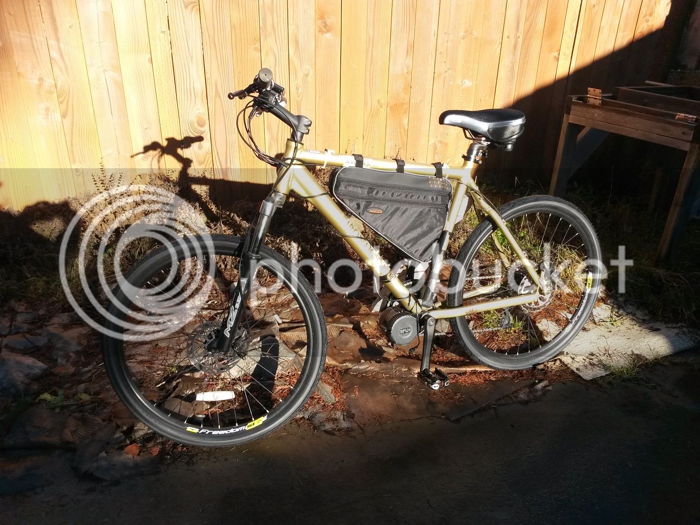

Here is my build on a Ironhorse Maverick Aluminum Hardtail.
With the 12S 10AH LiPo Pack, it weights in at 49.0 lbs.
Just waiting on some Electrical connectors so I can complete the install. Hoping to be riding it soon.
This is my very first ebike build, and I can't tell you how easy it has been so far, although I suspect the electrical connections will be the most difficult part.
