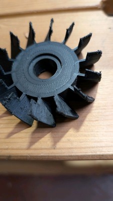

I just saw online their is a cooling system now for this c3000w . Looks like a fan and cover and drilling template made by AFTebike it says
