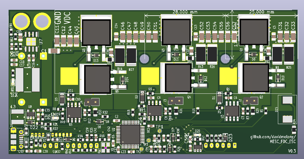

I know your reworking the PS, but I got bored, so I tried fitting the 64 pin MCU...
Much bigger. The board will have to grow.
I would throw that design away once you're finished looking, the next check in will have better PSU and analog inputs... Quite different. Also more jlcpcb ready.

PCB updated, so Squeegee can fiddle with it provisionally. Not going to order for a while, but I think this will be all the connections it will ever have - it has ADC, UART, PWM, I2C/GPIO, CortexM, USB... seriously, I don't think it needs anything else. It's an ESC, not a do everything controller.
I also dropped the H7 144 pin into it just to see. It's enormous. One for later. Much later, needs opamps and stuff anyway. I have a nucleo H743, I'll see if I can compile and run the code on that one day.

Had a quick look, I don't mind going through and "fixing" it. There are thing like these that are not good,Capture.PNGbut I'll spend the time only if you want me to... don't want to be a bother.
I hope your not going to stuff that 144 monster in there... as you said it's an esc. I'd be curious if it test fine on it though.
You proficient with GIT squeegee? I have a... poor working knowledge. If you want to check out the branch, fix it and check it back in, you can. If they are the only issues, might be easier if I do them. That said, it's often easier to spot problems on other people's stuff than your own, and I am not the tidiest person I know, so could be useful!
The 144pin version is not going in, for now. My long term goal is that the code is trivially portable, so at some point I'll make a board with that 144pin monster on it purely to test the portability. It may also be fairly easy to port the code to a 3 sensor VESChardware (I don't think I'll ever try to support 2 shunt, it's a pointless saving). Forking the hardware is certainly not my current priority.
