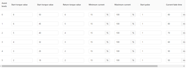

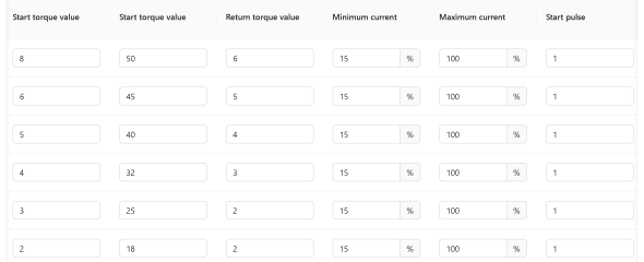

In the OpenBafangTool, in my opinion, it has not 5 torque assist but that are sort of speed ranges or rpm ranges? it doesn't matter, it are probably ranges just like on the UART torque.
First vertical column in OpenBafangTool are those ranges. The second column are the start torque value's in Kg for each range. The third vertical column (also named start torque?) is the full load Kg. Say your idle torque voltage is 750mV and (for example) your max assist the torque sensor can provide is a voltage of 3300mV and the value in that column is for example 50 (Kg) then you need 50Kg force on your pedals to get the FULL load torque assist in that particular speed range.
The further you go down in the speed table (first column) you will see that you need less and less Kg on the pedals to get certain torque assist at higher speeds.

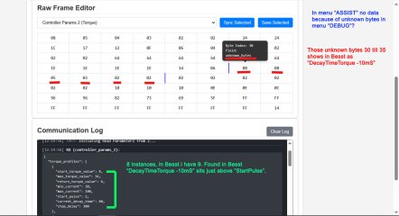

AudreyPR's is nearly there, but I think its missing part of the setup, that of the torque sensors Delta Voltage

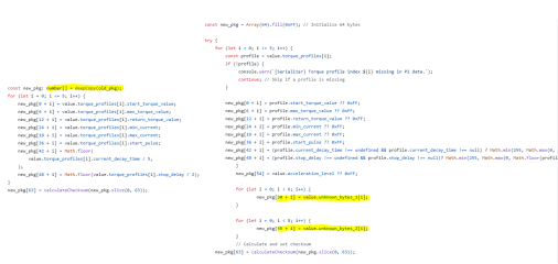

Ah, I guess this are the bytes that @bart594 calls "Unknown Bytes" (index 30 to 35 and 55 to 62) He reads and writes them, just like @AndreyPr, but we have no menu to edit them yet. But should be very simple to implement. @bart594 has a smart debug function, that let you have a look in the variables and raw data (y)
Of course, we have to identify, which byte stands for which value in the delta voltage table.

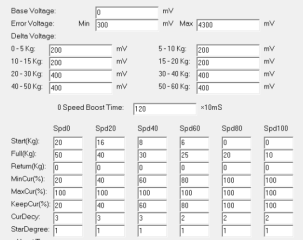

@AndreyPr. Thanks for the reply. The Spd functions are available on this motor ( Spd is not speed per see but a part of the overall torque sensor function calculation ), I would suspect that the Voltage part of that sensor is also there and if we could access it in the same manner that those tuning the Bafang Ultra motor do, then we could tune that torque curve ( which the motor desperately needs to be anything like a good motor ).
The little M820 motor has so much potential, 2.7kgs, seems happy to put out 600Ws, is very compact and yet the manner it operates from the factory really makes it almost one to not bother with. Resetting the Spd columns does improve the motor however but unless we can get to the voltage section, then we will never really know it’s full potential.
Thanks for your time to get the program this far, we can probably get a reasonable tune with just the Spd parameters.
It seems that index 30 -35 belongs to 6 instances "Decay time of the torque - 10ms" visible in BESST program itself. I think it 's just not yet implemented to show up in Andrey and Bart tool.
Do you have a screenshot of that tab? I have no BESST and didn't find a screenshot of the torquesensor settings in the internet :confused:
Regarding this post:
The linked article says, that the speed table defines, which parameters are valid in which speed range. So the rows (the columns in the old UART tool) have nothing to do with the assist levels, but with the speed range. That seems to be important to know!
This table could be represented graphically as follows:
This means in the speed range 0-5.5 mph you need 40kg on the pedal to get the max. current, at >25mph you need only 20kg on the pedal to get the max. current.
The mapping is better explained in a single diagramm perhaps.
