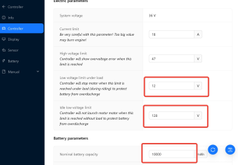

That's well known, Bafang has changed the CAN protocol obviously, this issue is fixed in the Bafang canable tool already. But Bafang seems to release OEM specific firmware meanwhile, so depending on your firmware version, some things will work with the BESST (and alternatives) and some not. That's my experience with my hub motor controller also.Also the "Lower voltage limits" can not be right: with "under load" it shows 121V (!) and "without load" 24V...
these are not my values , only demo values from the program. things are changing rapidly so i want to ask before ... i understand that in current state changing voltages is not reccomended@pxl666 your system voltage shows as 36V in your picture, not 54V. And for what is in the thick red rectangles regarding voltages, read the 2 posts right above yours.
OpenBafangTool does show the value for "system voltage" and "high voltage limit" correct. So if you look at these, and then look at what is in the red rectangles... That should ring a bell that what shows in the red rectangle can't be right... Which means - don't change those value's - in the red rectangle or...
Yes I made this experience.these are not my values , only demo values from the program. things are changing rapidly so i want to ask before ... i understand that in current state changing voltages is not reccomended

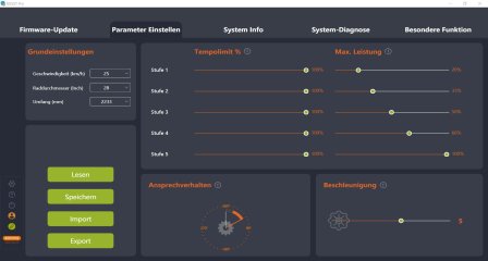

Bafang canable pro masterКакой смысл в этой программе, если я не могу изменить ограничение скорости? Единственная причина, по которой кто-то может использовать этот инструмент, — это разблокировать это дурацкое ограничение скорости, но это невозможно. Чувак, почему
endless-sphere.com
not really . i personally have other things in mind and speed limit is only on the list but not on top ...What is the point of this software if i cant change the speed limit. I mean the only reason why would anybody use this tool is unlock the stupid speed limit, but it is not possible. Dude why?
