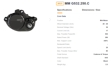

The little Bafang M820 motor is starting to be used in a number of frames, both Gravel and EMtb. Its tiny in form, weighs 2.3kg's and for all intents and purposes should be a great little motor putting out circa 500 - 600W's, ( I'm using 52 volts on 48 Volt firmware and seeing 620 W's at the battery ) what more could you want.
Sadly for the EMtbers amongst us, the firmware programming is not the best and has such limitations one has to wonder whether the slightly heavier big brother M510 ( which is a great motor ), may well be an option with lots of adjustibility for the users needs. If you want small form, limited power with low weight then the M820 is still an option particularly for road and gravel use. The one downside for me is compared to the M510, the M820 is more noisy ( my motor is relatively new and may well yet quieten down with more use ).

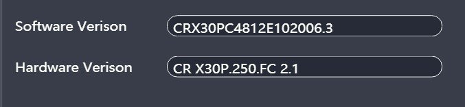

I'm sure that with 36V versions firmwares changes made via CAN in spd table will not give any effect.
So can You share your firmware version ?

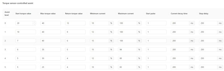

Just to get things the same I'm using 52 volts on
The parameters from the factory with this firmware were.
On the road this was awful to ride feeling quite dull and not at all lively, more about just economising on using least W's to achieve a certain speed.
Off road it was truely awful. Off road you could get into a state at higher cadences after a long climb where the motor feels as though it is cutting back due to over heating, dropping back to just under 300W's in Boost. On doing a few climbs I realised that my cadence was dropping back to just under 90 from around 92 -95 and although not feeling as though, almost certainly putting not as much pressure on the pedals.
After a few trial and error programmings I've ended up here.
Now there's another factor in this, Speed. Using a BBRacing plug on device I can change the max speed realtively easily on the bike. As per Smorgasboards musings, as you increase the max speed the more spread the changes over a wider speed become. Speed definately has an influence on the parameters and anybody playing with the settings will have to find whats best at there max set speed I'm afraid. I'm all off road so the higher 45km suits me better and is probably equivalent to the 2 magnet solution Smorgasboard talks about.
So I'm sort of leaning to the following in the Spd Assist parameters, possibly correct, possibly incorrect ?
Assist Level is levels of motor speed or in our case cadence. Those with a lower cadence will look at the lower levels for the most results.
Start Torque is exactly that in Nm where 60 is the max.
Max Torque is the max torque sensor output at that level. In my case at level 3 I want a full spread of the torque sensor as its where in my cadence I can exert max pressure. Level 5 I tried that at 60 but found the motor was not smooth, my peddling at that higher cadence couldn't exert max pressure through out the full rotation of the peddle and the sensor was outputting a varied output, the bike felt jerky and really not smooth at higher rpm.
Return Torque I'm not sure about, it seems to have some influence on the way the motor reacts when it reaches the max speed. I'm not clear on this so more research please.
Min current is, again I'm not sure, but I think when the Min Start Torque is reached, that is the beginning current at the start of the ramp up.
Max Current is I think the max current needed to maintain a set speed. So at say 20mph X % of current is needed to maintain that speed. Again I'm not fully sure here but off road I set it to a max 100%
So please lets take these things not as gospel but just as a starting point to try various settings and see what actually suits your requirements. Report back and let us know how you are getting on as the more users try it, the more we will begin to get a full understanding.
