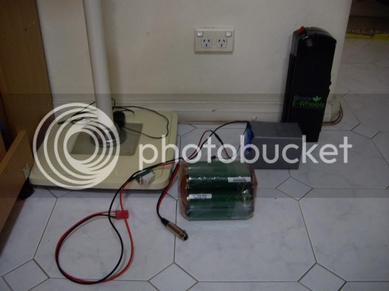

hey lazarus i did post up my main battery in the post above, its that blue rectangle thing in the black casing.
as long as you don't need more amps than the main battery can give.
how can i control this? by not accelerating too much?
Oh, sorry, I didn't realize that that was your main pack... thought it was a friend's LiPo. Anyway, that red wire you mentioned might be the right one, it might not. How do you charge your main battery? Do you use the same wires to charge it as to discharge it?
And the controller will limit the amps for you. Since the controller has a limit of 16a, and the controller and battery came together (correct?), it's safe to assume that it's safe to draw 16a from it.
It's difficult to tell the type of cells used in the battery, since it's all heatshrinked. However, even low quality cells are good for 2C-3C. I wouldn't worry about it unless you buy a controller with a higher current limit.

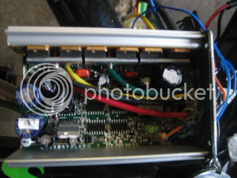

ok well i took my controller apart time and i see that the capacitor is 50v, and theres 2. There was a previous post where someone said u can overvolt it if they had a look inside. Also i found the model number for my controller which is KTW-PSF6 2007-3-3
Yeh and now its such a bitch to put all those wires back into the casing for the controller that came with the bike! I feel like suiciding when i look at it ....

I have taken apart my controller to have a look, no problem with upgrading the caps to 63v but the fets (stp65nf06) are rated at 60v which is a little too close for comfort, correct me if I am wrong but I think voltage spikes can occur under load or acceleration which would exceed this from a 48v pack??
So like you, got the bug now and want just a little more top end speed. have recieved a ecrazyman controller 48v 30a, but instead of fitting it to my current greenwheels machine I am building a new one from scratch. Waiting on a bafang hub, as I like the freewheel and torque for size benefits.
When I received my controller I was surprised at it's size, it is twice the size of my current controller which makes it rather obvious on the bike, which only reinforces my belief that my old controller couldn't handle the increase to 48v!

I just found another problem, that is overvolting to 60v might blow up my throttle indicators! Does anyone know if it will and if so how should i fix this?

I have bumped up the voltage on my Greenwheels (aka bafang motor) Bike
the controller supplied is the weak point and limits the voltage and current capablities!(rated at 36v 15a)

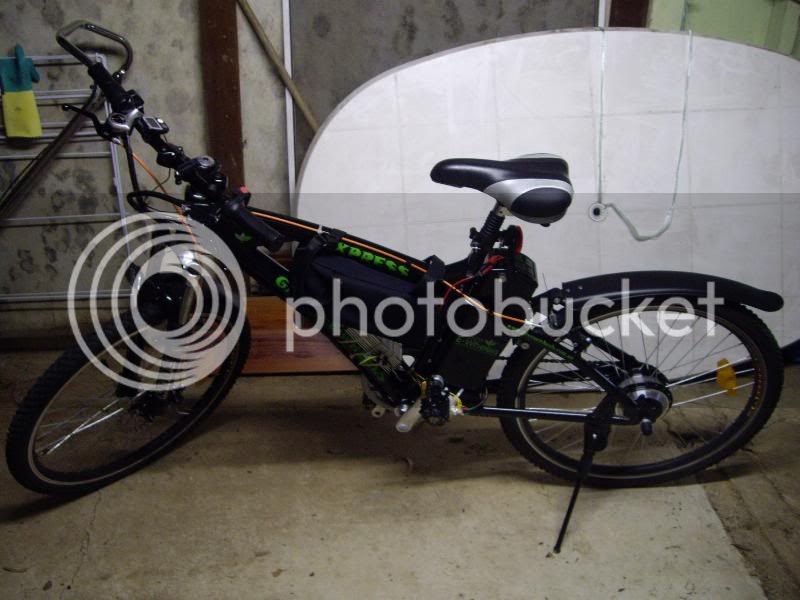

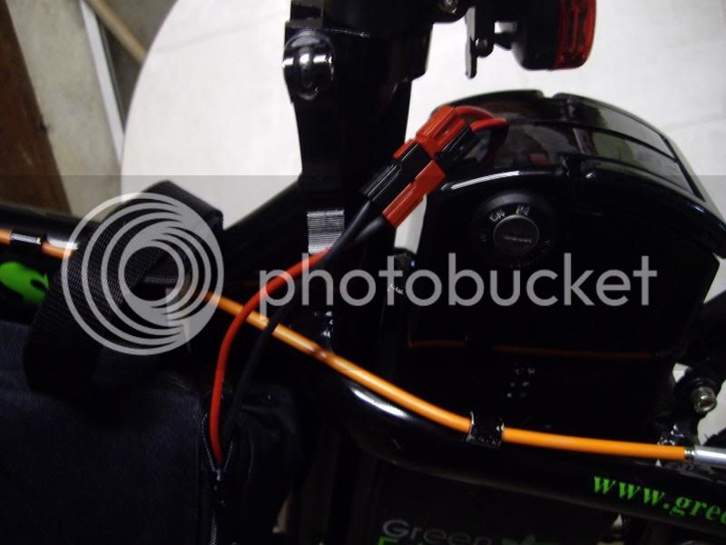

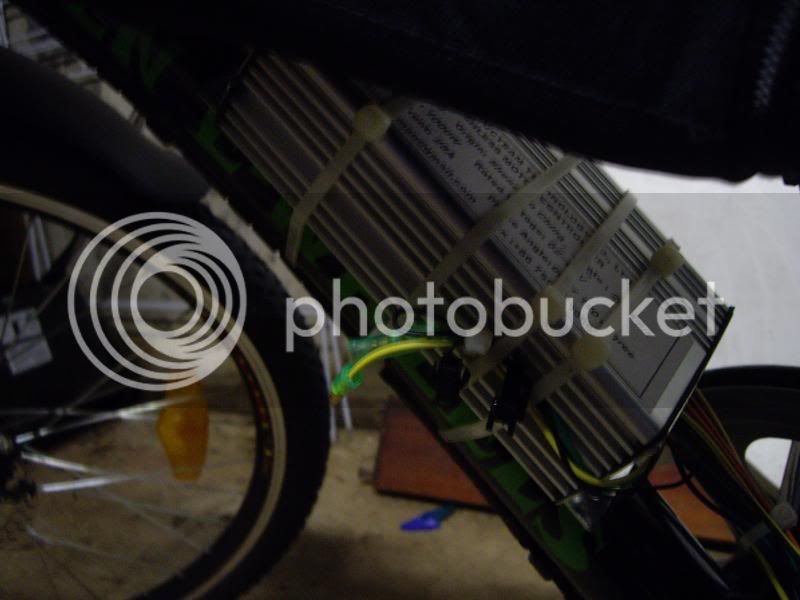

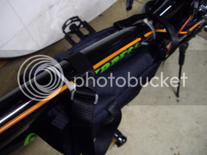

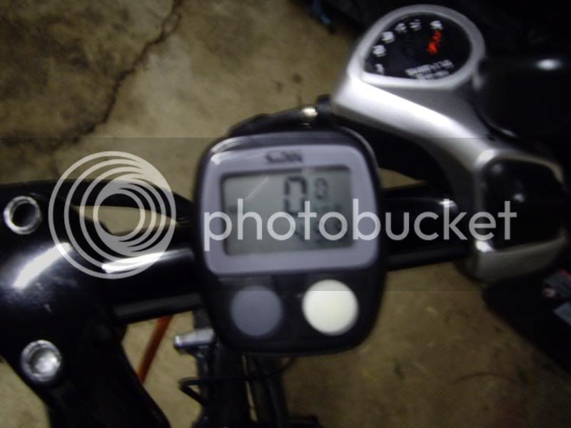

FINALLY! IT IS FINISHED! thankyou to all you guys that helped me out, i really appreciate it and i will share the knowledge i learned from this forum with others in the future.
I just finished setting up my bike after a whole week of work, my flat speed now without pedalling is 44km/hr, with pedal is 49km/hr. I used to go up my street at 20km/hr on a hill, now it goes up the hill at 36km/hr!!!
I also managed to get the throttle battery indicator to work, but for some reason the green light (full) dropped down to yellow, i dont know if it was blown or maybe lost a bit of power there, it turned on before until i rode it.
I will post some pictures for you guys later. I learned everything from scratch, i had no knowledge about electronics when i started.
Meanwhile i will work on my 2nd project, installing the 500w cyclone kit on my old mountain bike.
Here are the photos
The finished product of a few weeks of effort.
I'm not planning to ride in the rain. so exposed wires will do for now.
This is where i secured my controller. I took the bottle mount off and used that same screw to screw on my controller. The controller gets cooled while i'm riding which is good.
Connected in series with my favourite anderson powerpole connectors!

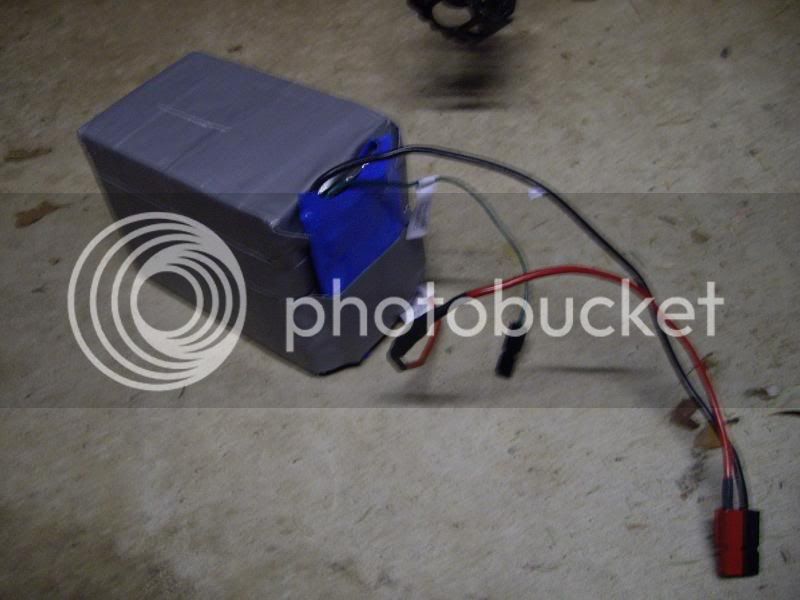

i mounted the extra 24v 10ah Ping Battery in the battery bag that came with my cyclone kit, im gonna use this for now until i find another battery bag. but it holds really well.
Max Speed 49.9km/h !!! dammit couldnt make it to 50, will try tomoro with a fully charged battery.
My 24v 10ah Ping battery
The batteries i own.
