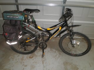

So I've been commuting by e bike for 10 months using a bashed commercial ebike(see sig).
I have been reading this forum everyday since I started.
I have been researching for a build I plan to start this month. Problem is I like everything and just can't commit to a build........ Just about every style I get excited about for a week and then I start putting more thought to the design and realize there are negatives to it. Just can't commit.... its really making me kinda sad...... don't even want to research anymore as I'm kinda getting burned out.
Budget: 3k
Daily commute: 17 miles round. Mild ups and downs with one short asskick hill.
Terrain: glass covered pavement for 8miles and a 1/2 mile of gravel.
Preference: some days I like to pedal a lot. Some days I don't pedal at all.
Condition: I am fairly fit. 30yrs old. 6'3" 180lbs
Skills: work in sheet metal shop, access to cnc and welding etc. 10 years of battlebots an rc planes.
So it has to be typical upright. I can't decide on what bike is most practical for the commute. Part of me wants a DH Style frame but the part of me that likes to pedal for 20 miles without powering up thinks not. Road bikes are not my thing. Hybrids might be but I don't know. The one bike that I seem to be sprung on is the Surly Big Dummy, I can afford it but the cost makes me sick, that's a used car!
Then there's the whole hub or crank driven debate going on in my head for weeks! Almost like I need to build a bike for each of my personalities ......

A pure DH bike like my Norco Shore2 is an absolute pita to pedal- bouncy, one front chainring etc.
Probably a decent duallie like a Trek Fuel EX or similar.
What sort of motor? Friction drive is out due to the off roading. Mid drive RC style is out due to complexity (I'll be doing one to complement my mac...or cromotor...or new scooterhub coming up soon...see, same dilemma as you!) Something like the mac geared rear is a nice fit and not at all heavy compared to some. If you up the volts and limit amps with controller and Cycle Analyst, it would be an excellent commuter with 50-60km/hr capability depending on motor winding chosen.
Batteries- 48-60V lipo, 10-15Ah? Can't really tell you how much battery to get as I have about 50Ah on my bike and don't have any idea how far it will get me....yet...
I'm sure plenty of people will chime in to help confuse you even more.
The cellman geared kit is easy though.

For 3k you can build a nice full suspension bike that will be a comfortable commuter and give you the chance at doing a bit of off-road stuff too. Still it will weigh 50+ lbs if you start out with a 30LB bike more if you use a DD motor. It will be more stable at higher speeds than something without suspension. A cruiser style bike would probly werq but be less stable at high speeds and not as comfy on the commute. Probly about the same weight.
Don't be in a rush I spent a year gathering parts for my Giant trance build and have been very pleased with the results. Had I not been so patient I would likely be doing some of it over. Although that's not all bad if it leads you to the bike that serves your purpose.
Second hand Aprilia Enjoy rebuilt with 8s 3P (17Ahr) Lipo and twist throttle, a grand max , with batteries to spare. Dead silent for the city commute, so you can sneak up on the Lycra. Crank drive back thru the 6 speed gears for good city starts and hillclimbs, or switch up to top gear for the big straight runs.

Cellman 1000w greared kit with a upgrade controller. A 72v battery for 30 amps. 20ah. Lipo or a123. Drop Ilia a line wwwebikessf.com he's getting some new motors.
Find yourself a used Big Dummy and make a mid-drive! You won't regret it! :D
Just remember, until you try, you won't know what you like best. Keep to off the shelf parts as much as possible, and that way if you decide you don't like what you have made, you can always re-configure it.

Wants a longtail and can weld? It's a no brainer where you need to head for one of your bikes. I'ts obvious you will want at least two, and have the budget if you don't blow too much on a mundo or dummy.
I weld for dogshit, and easily made this, once I managed to scrounge the right old frames. Hard to spot it, but that's a steel FS frame cut in half for the rear part. So it's a FS longtail! Sweet on a gravel road. Frankenbike longtail.  Bouncing Betty..jpg
Right now I'd suggest looking for a decent used full suspension mountain bike. Specialized FSR is one good pick, it's a cross country design, focused on good uphill pedaling so it will pedal much nicer than something designed to go up on the ski lift. Goes without saying, you want FS for the gravel bit.
I built my main commuter on an old Giant frame. DH ish for it's day, but nothing special now. 4-5 inches of travel. Set the suspension up fairly stiff, and the pedal bob is quite tolerable, but you still have travel there if you hit a chuckhole at 30 mph. I rode this bike though the usual rocks and glass for 15 miles one way for about 8000 miles. For tires, I just went with ones that were going to last about 2000 miles max, but had some tread to keep the cord stood a bit further off the glass. Just cheap bell tires, in the comfort bike type. Cut one at 500 miles, no big deal, cheap enough to keep a spare in the garage at all times. Thick tubes and slime for the mesquite thorns and smaller nails.
Since you want to pedal without power some, get the cellman Mac kit. Likely the fast version. Can run it on a 48v 15 ah pingbattery for convenience, or the cellman battery if you have the budget. He can make you a pouch cell A123 battery that would be larger capacity btw. just have to ask for it.

Been doing the double kickstand on bikes for quite some time, with two frames and two mounts, a real no brainer. Just had to weld or bolt on lentheners for both of them.
The FS longtail is named Bouncing Betty. Inspired by Zoot's longtail Le Bette.
