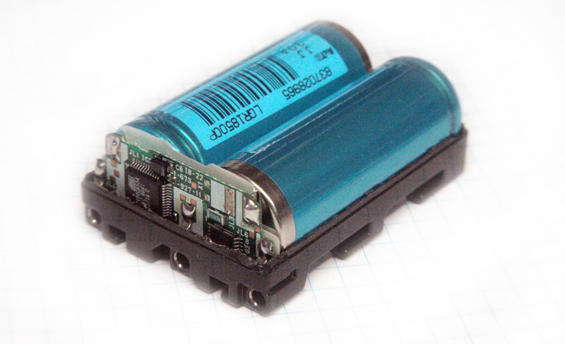

18500 shares the same 18mm diameter with 18650 but it's 15mm shorter (18x50mm).
This size is often used in digital cameras' battery packs, usually in 2S configuration.

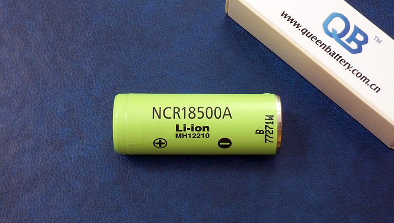

Panasonic NCR18500A
This flat-top cell's heat shrink tube contains the model number, "Made in China" mention and B 77271W marking. The tube doesn't go over the negative pole and ends in 1.5mm to it. It's common for 18500 cells.

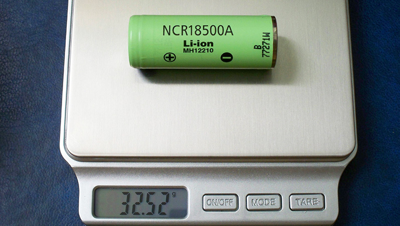

Measured dimensions: 18.2mm (diameter) × 49.2mm (length).
Measured weight: 32.52g.
