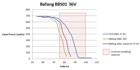

pjgold said:
However a BBS01 100%=80 rpm and 75%=60 rpm
I measured 0.85 rather than 0.8 but I didn't go past 50%. Interestingly at Limitspd% 100%, cadence is not controlled but depends on the motor characteristics. I've had assist with cadences as high as 97 rpm but it is battery voltage dependent and drops as the battery discharges. Operating at full power I've found the cadence vs power data to be higher than published by Bafang. However, it is lower than desirable as it runs out before the average human.

pjgold said:
The limited percent rpm is a direct percentage of the max rpm of the BBS unit which is...
120 rpm for a BBS02
80 rpm for a BBS01
So on a BBS02 75%=90 rpm and 67%=80 rpm
