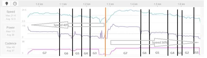

From the test data above you can see that in this case the controlled parameter is the cadence not the speed. In this test case the limiting speed of 40 km/h was set in the controller rather than from the display and Limitspd% was tested at 40% and 50%. The controlled parameter should be speed rather than cadence, is it for anyone else?astmacca said:Has anyone found that the speed sensor is used by the controller to vary power output on their motor?

Yes but the test data shows it is not which is why I've asked here if it does for anyone else.astmacca said:Given the units, that information HAS to be coming from the speed sensor at the wheel rather than the motor controller since actual road speed is independent of cadence because of the gearing.

Pjgold's explanation for the "Keep current(%)" parameter is not consistent with my test data. However, pjgold also says "Current set to 100% the assistance level does not change at all from what you select." which is close to, but not exactly what I see. I speculate that it is a PID controller http://en.wikipedia.org/wiki/PID_controller and that Keep current(%) is the proportional gain parameter. With a PID control algorithm, the higher you set the proportional gain the closer the controlled parameter, in this case current, tracks the set point value. If the proportional gain is set too high the controlled parameter becomes unstable and oscillates which I haven't seen in my testing. Therefore, if you are aiming to keep power constant as specified by the level setting 1-9 regardless of cadence, which is what I want, then setting Keep current(%) to 100 works best. Pjgold and Kepler both recommend a "Keep current(%)" setting of 100% and Paul from Em3ev recommends against 100%. I suspect that once "Keep current(%)" is at 100 then "Current Decay (1-8)" has no effect but I'm not sure of this or exactly what "Current Decay (1-8)" does. I suspect "Current Decay (1-8)" is the integral parameter in the PID algorithm and the proportional gain is high enough at 100% that adding an integral component does not produce an obvious effect but this is pretty speculative. "Current Decay (1-8)" definitely modifies the effect of "Keep current(%)" at values other than 100. Following the suggestion that it is a PID controller we are adjusting to its conclusion, I suspect "Slow-Start Mode(1-8) is the derivative parameter in the PID algorithm but this is untested.astmacca said:On page 22 pjgold opined that the Keep Current setting may be a hangover from hub motor operations (or at least thats what i think he means).

At high speed in low gear you might be exceeding the maximum rpm of the motor. Better to test at low speeds, perhaps 20km/h. Try your highest gear and lowest gear on flat ground and see if you always get the same speed. You need to pedal but try not to add any human power.astmacca said:Well, my first session of testing round and round the park today had me convinced the motor was controlled by road-speed. Was in a mid range gear where the speed limit % on the PAS setting happened to me very close to what i thought it should in km/hr as a % of the display set speed limit. Thought to be consistent i should do all the testing in the same gear so ration wasn't a variable.
Not until i purposely tested in an "extreme" config (set 50km/hr on the display and was in lowest possible gear) that it became glaringly obvious i was wrong and that the road speeds / PAS level were nothing like what they should have been in km/hr as a % of the display set speed limit and that the motor was not even trying to get there, that the penny dropped.
The controlled parameter is cadence. The gearing then defines the speed. See that the speed changes as the gear is changed but the cadence remains the same.astmacca said:Ken, you say you had the power set to 100% and speed to 40km/hr but on your plot it only gets to a max speed of 21.6km/hr?? How come? Is that all the BBS01 will do on your trainer set up or is there something else going on there??

As stated a few posts back http://endless-sphere.com/forums/viewtopic.php?f=28&t=58780&p=958593#p958358 from the accompanying graph I get 0.85 rpm per speed setting% for a BBS01 but even in that graph there is a slight load dependence. I would guess the BBS02 is 1.3 based on the maximum cadence being 130 rpm. The load dependence would be much higher at Keep Current(%) values less than 100 and Current Decay (1-8) changes things too at values of Keep Current(%) less than 100. I didn't test the dependence on Keep Current(%) during cadence control but I think it follows from the observation that current becomes a function of cadence at Keep Current(%) values less than 100.Aushiker said:How does one determine the relation between the cutout (%?) and cadence? Say if one's natural cadence is 80 or 90 what would the cutout value be?

No it doesn't. Well, very little at the values I tested. Again see the graph at http://endless-sphere.com/forums/viewtopic.php?f=28&t=58780&p=958593#p958358 Notice that cadence is almost constant regardless of gear which goes through a range of 12 to 34 teeth and working against a load intended to be equivalent to the load at that speed on a flat road.astmacca said:Depends what gear you are in.
