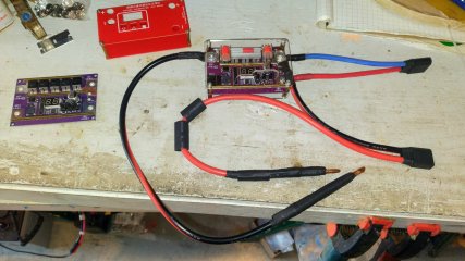

So, I just got the AwithZ P60F.
It's clear I don't know what strength settings to use, because my probes are sticking and nuking either the probes or my test cells.

The P60F has higher voltage. 9V vs 6V, and also almost double the current of the UF20B.

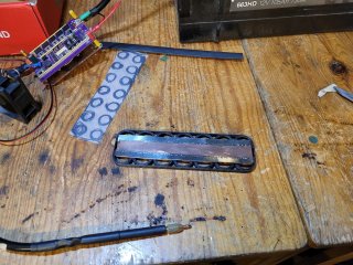

I used a razor knife blade, the trapezoidal shaped ones, and started out low and increased gears by 25 until the welds started sticking. Only one weld sticks at first, and one can see the result on the underside of the blade.
Keep increasing gear until both welds are the same size on top and below.
The Bells and whistles like double and triple pulses, preheating and the 'intermittent' the delay between preheating and the first weld pulse are distractions at this stage.
Set it to single pulse, No preheating, and worry only about the Gear.
When you get both welds to look the same size and shape on both sides of the razor blade, then try those settings on an actual cell. If the welds are strong, tearing the strips of copper/ nickel, then one might be able to use less power. Go down in increments of 20 of the 999 gear welders until one weld is obviously much better than the other and then go back up.

I am really well dialed in on 0.2mm copper now, using 0.1mm stainless and flux. Gear 385 double pulse, 0.15ms preheating, 04ms 'intermittent', and 0.2 seconds interval( between weld pulses) AwithZ p20B welder,14.6kw.

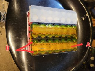

My first spot welding job on 21700 cells 10S2P.
AWithZ UF20B performed amazingly well on 0.20mm Cu, 0.10mm 304 SS. Every weld felt good and consistent. No probe sticking! Need to order some Silicone wire to finish.
