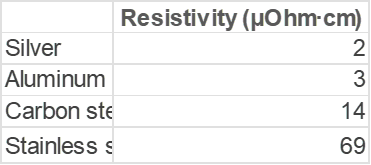

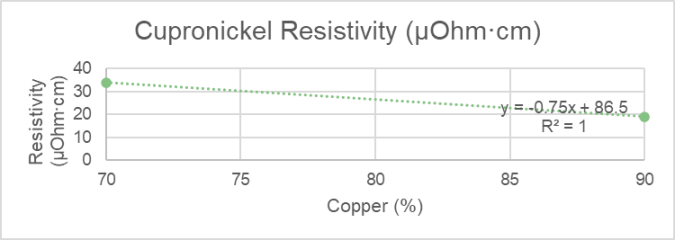

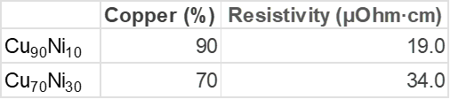

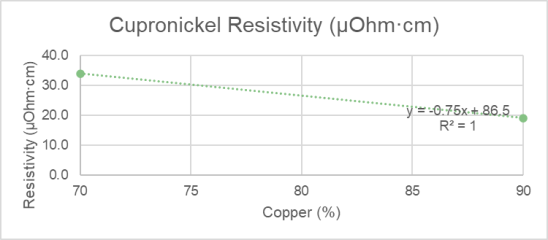

Oh yeah, stainless steel is an actual nuke when it comes to these things.
Any alloy of copper significantly reduces the electrical conductivity.
Far more than one would expect. It is not linear.
Indeed:
For comparison:
However, all cupronickel alloys -- including pure nickel:
