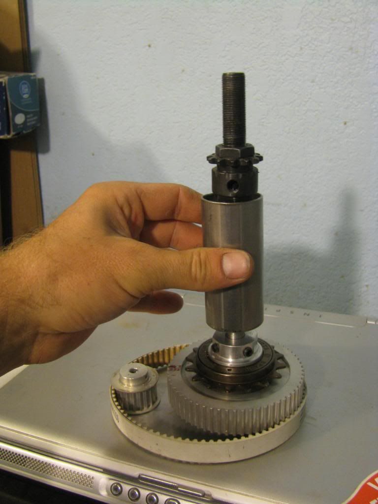

Here is the mockup of the drivetrain I plan to run:
Ok, so here I have the 7KW Collosus, but I plan on using a 130 KV Turnigy 80-100. Drive system is 15mm GT2 belt drive 20T motor 60T jackshaft. I am using a hollow steel BMX shaft and one of Recumpence freewheel to shaft adapter. I will use screws to attach the 16T Dicta freewheel to the 60T pulley, allowing the motor to freewheel. I need to find a low profile bearing for the pulley, or I might incorporate a one-way bearing here for instant throttle response without the freewheel delay. I also plan on using a much shorter Jackshaft tube, this is just for visual detail. OK, on the other side we have a 14T #219 sprocket which I will probably weld to the shaft, going to this sprocket:

I think this build should move fast. Most of the lathe work will be done tomorrow at work, I don't think my lathe has the accuracy for these rpm's and I want a smooth drivetrain.
A few minor changes:
1. Rather than use a 1/2" shaft adapter for the 14t 219 sprocket then welding the whole mess together. I have decided to get a 3/4" shaft and taper the other side down to 1/2" for the freewheel adapter and one way bearing.
2. I'm going to attempt an eccentric jackshaft housing for belt tensioning. Basicly, chucking the housing in my 4 jaw chuck and boring a hole off center. I have many years of practice at this. :lol:

Hey Etard,
With that much torque, you will probably need to go with 20 or 25mm wide belt. That 15mm wide belt will probably skip. I have found 15mm wide belts tend to skip above 5kw or so (not sure the NM torque, so this is a loose number). Or you could move to a Gates Polychain or Contitech Syncromesh belt in the same 15mm width. They are the same pitch, but much tougher material.
Personally, I would move to a 20mm or 25mm width.
Definitely,..... etard, i used what you have planned on my blue cruiser and it skipped a few teeth

That is a good point on the belt slip, I may have to rethink my gearing combinations and just go with the kart sprocket on the disc brake flange and put like a 20 something tooth on the motor. With a large motor pulley, belt slip shouldn't really be an issue, right? It will be easier to mount the standard sprocket than the cam sprocket I suspect.
AJ,
What size motor pulley were you using? I have a 20T here that might give me a little more engagement. If I use the 95T sprocket on the rear, I may need a much larger motor pulley anyway. I am just trying to get this together as cheaply as possible with parts I already have.

I found this go cart rear hub and a tube I had cut for some bearings, so I will prolly go this direction. I'll just use a hole saw to cut out the motor plate that Thud left on the bike ( thanks bud :p ) and bolt it on. The mount to the left in the pic is a thrift store find I was gonna repurpose using 3/4" needle bearings. That setup would be fairly stout, but I think what I have will do. On the sprocket side I have bored out the key way on the ends so the bearing nuts from the old hub are squeezing the sprocket centered. I'm gonna try Dimpling the shaft and using the set screws to hold it in place. Then I'll drill a hole in the sprocket body , heat it and fill with solder. Crazy enough to work?
Finally getting around to making a sprocket adapter. This piece was a little small, but the biggest I could fit in the lathe. It's thick enough to either cut in half and make 2 or dish the sprocket in toward the wheel more. In order to ensure it is round, I will drill and tap the mounting holes, and then hold the sprocket in the lathe to cut out the center. I'm having fun and feel lucky to have all the tools I need right here. Although a welder would be nice to have, huh Thud? :x :lol:

A little progress today, got the sprocket bolt pattern spot on and tapped. My first try was horrible, then I realized I could cut a small indent around the outer area where the sprocket mounts to. By making a lip for the inside of the sprocket I could then be sure the sprocket was centered, clamp it, and drill the holes through the sprocket. It worked great and now I need to do the same for the disc brake bolt pattern using the inside of a brake disc. I also found I larger motor pulley, not sure it is GT2 like the belt is, but it's close enough for jazz methinks.
Sprocket adapters are hard to make! Well, not so hard as time consuming. Here is the adapter all tapped and drilled, I'm now waiting on some rims from Matt so that I can lace up this hub to figure out the sprocket offset necesary to clear the tire. I may not need any offset, if so I might attempt to cut this chunk of aluminum in half so that I can have two. Time to move on to the jackshaft...
I can't tell you the reduction cause i don't know what sprocket was on the motor. I can tell you the driven sprocket was 48 tooth.
My 2cents Etard, you can put an idler next to your motor pulley and get more wrap on it. Every extra tooth you get wrapped to that pulley increases it's ability to transmit power. Might get you buy without new belts and pulleys...
Thanks Danny, I may have a go at the idler, otherwise, I will try this 30 tooth pulley. I don't really need much first stage reduction as I am going with #219 chain final drive so maybe a 2:1 belt drive will be plenty. Still not sure on the motor KV I will be using, if I go with this 180KV motor I will have to invest in an HV160 to keep the rpm's low and still get power.

My primary pulley supplier is Pfeifer Industries. However, their production prices are really high on some stuff and reasonable on other stuff. So, I have them make the larger pulleys and I have another shop in the area make the smaller ones. There is a huge difference in price on the smaller pulleys from one shop to another.
I have found that motors of this torque level require at least 20mm of width to survive and 25mm gives a bit of headroom. Of course a wide belt affects the Q-factor and drops the efficiency a tiny bit.

I'm hoping the 15 mm belt holds up with a 30 tooth to 60 tooth setup, and maybe even an idler added to give more wrap as Danny suggested. If it doesn't I guess I will be pitting an order in for a proper setup from you.
