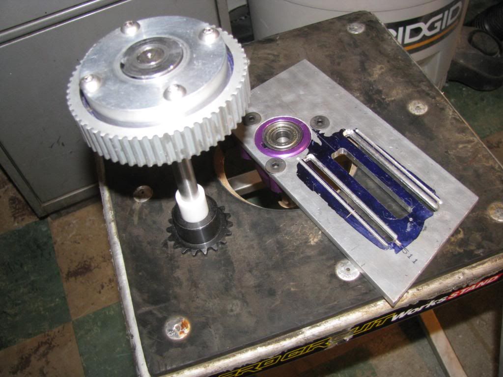

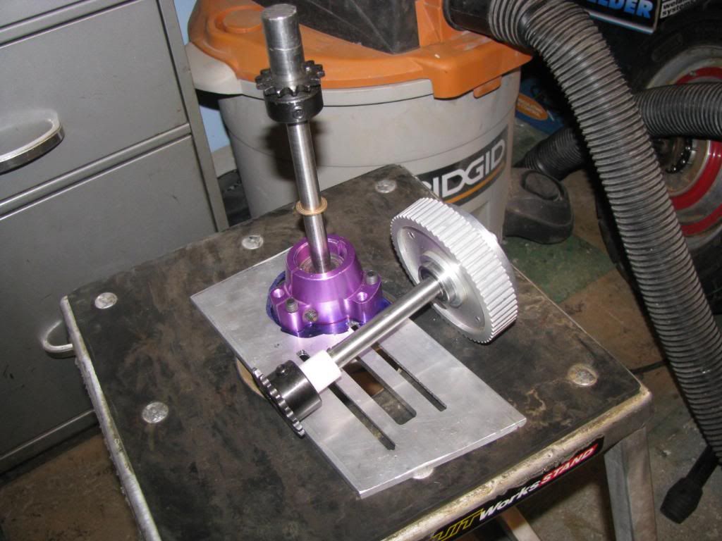

I got a little progress done last night, I'm not too happy with the setup, so we will see if it lasts. I decided and try an 8mm shaft system for the jackshaft. It's kinda dainty just looking at it, but I'm working with what I have here, so we will see how it goes. I recently picked up a stock Turnigy 80-85 170KV which I plan to run with my Castle HV110. I hope to have it running this weekend. Things left to do:
1. Sliding motor mount/ jackshaft plate
2. Drill sprocket adapter for disc hub mounting.
3. Prep motor pulley for shaft mounting
4. Rig up #219 chain tensioner and link 2 chains together
5. Lace up rear wheel with new SS hub and wide rim from Matt
6. Weld brake posts on
Ok, all that won't be done this weekend, but I hope to at least get a rear wheel spinning on the bench. Oh yeah, and a big thanks to SoSauty for sending me his spate parts, I will b using a few for this build. :p
Got a bit of work done this weekend. I will probably be slowing down a bit as Jay and I will not be able to make it out to the Grange track. :x
I have managed to get the width down less than 5 inches and shouldn't clip ankles on spinny parts (always a bonus). I got the mounting plate done, I just need to finish pressing out the motor shaft and cut the shaft and flatten the drive side for this pulley. Then I can get it mounted. I will probably have to space the plate off the mounts by about 1/2". I'm debating on lacing this wheel with a dish toward the pedal side and attempting a disc brake with Hope Monos. The hub is much wider spoke flange than a cassette hub, so strength shouldn't be an issue. Plus it might actually be easier than mounting brake bosses for rim brakes.

I think it's gonna work perfect for this application. After I finish this one, I might make another one that I can swap in or out in less than five minutes. On that one I will put three one-way bearings inside a tube and see if I can't get rid of the freewheel.

A little more progress on the reduction pulley, still have to bore it out for the support bearing that will go behind the freewheel, but I was happy when I found these allen bolts with "shoulders" on them, should work perfect for this application. They also look like they would work perfect as a chain tensioner bolt with a bearing on the axle part.
Here is the bolt:
AND I also won a proper toolpost on ebay today for way less than I expected!
look at all the love you put on that cast motor mount!
whats your plan for that? Glad to see you getting some use out of the old samples box.
I was hoping you would see that! Monster sprocket all the way bro!! I already picked up another scrap frame to hack up ala Thud 4 1/2" sparkomatic.
I was thinking about how to keep the freewheel from pulling into the pulley ( kinda need to keep it spaced out so it doesn't interfere) and came uo with a solution: sandwiching a bearing between the freewheel adapter and the pulley. That should keel everything aligned and together at the same time.

Ok, so I had a freewheel adapted to the pulley, wasn't content and wanted to try a sprag bearing from VXB. I decided to the 25mm would fit the bill with 68 n.m. of torque handling, which should be able to handle the 80-100 after a 3:1 reduction. We will see! Here are some pics of the jackshaft. I decided to go with a 1/2" to 3/4" delrin adapter for the #219 drive sprocket just to see if it softens or lasts in the application. I wish metal was this easy to machine! :x
I still need to order up some spokes, then I will have a roller!
The center part is attached to the shaft with set screws while the inner sprag ring is keyed onto the shaft carrier. The outer ring of the bearing is keyed onto the sprocket mount and also the sprocket. This setup is solid and a bit heavy, I just hope it is balanced! There is the motor plate slotted and ready to go as well.
