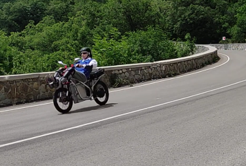

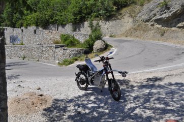

I want to hear more about how the steering fix worked out on the road ?
I also am very happy that you found another sofa lover I kind of think of it as you finally found another animal like you of course you had to go halfway around the world to find him in Canada.
I've seen others in Southern California but not homemade to the extent that you did.
The serviceability of the steering cup, that is, the easy sliding of the bearings, played a decisive role in my understanding of how to control a recumbent moped, because before I thought that it was hard to turn the steering wheel, this is a feature of recumbent mopeds, because a lot of the body weight falls on the front wheel.
But now I can responsibly declare that it is much easier to control a recumbent moped than a seated one, I think that the fact that the frame is still from a Suzuki motorcycle, and not made by me in the garage, and its engineers very correctly calculated the angle of the steering cup, plays a role here.
But the fact remains - now in the city traffic flow I do not need to put my legs out for support at minimum speeds (conditionally 5 km / h.).
Well, at decent speeds (70-90 km / h) my body and the moped seem to merge into one whole and ... stick to the road, this is really so.
Now that I stared at the photo profile of your bike I could see that the front forks have a good geometry to my brain as I looked at it earlier photos I didn't think it had enough break but it looks like it works. But you never know what kind of horse you got do you get yourself into saddle. At 66 I'm not sure I'd like to try it. I'm tired breaking my collarbone or waking Up in a hospital after a bike accident. And I don't jump off roofs anymore hell I'm getting old.

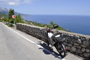

By the way, before becoming a sofa, it was an ordinary moped:

I am very far from aerodynamic air resistance, so I am doubly grateful for the proposals coming from those who are knowledgeable in this.
But! so far I do not accept the hybrid drive option purely for "religious" reasons, since all the batteries and the electronics that control them are already available.
In general, if we talk about the use of this moped, then it is mostly needed for long trips, this is its meaning, I already wrote earlier - with this aerodynamic design, it retains 30-40% of the battery capacity compared to the vertical position of the rider.
That is, if on a vertical moped I spent 43-46 Wh/km at a speed of 60-80 km/h, then on the Unicorn 30-33 Wh/km, and this is very important for long trips!

I didn't experiment with the frame length, but did it on what I already had, you know, I decided that it was easier to change my riding skills than the frame, and as a result, I learned to ride quite well on a reclining couch.
Yes, there are another 40 kg of batteries for the complete set in addition to the 20 that are already in the frame, they will be removable, each of their 3 batteries is provided with independent control electronics and will be connected in parallel.
In general, I'm glad that another sofa lover has been discovered.
I looked at your previous device, it has a backrest for a sitting person, but not a reclining one, why am I focusing on this? Because good aerodynamics on such devices are obtained when the air envelops the body, but does not rest against it, so even if we sit low, but at the same time our body is like a brick for the wind, the aerodynamics are still bad.
After all, we make such sofas not for the sake of relaxing on them, but to save battery.
I posted above the battery capacity consumption at decent speeds, this is 70-80 km / h on average, the consumption on the sofa is 30-32 watt.h / km. But on a seated moped, the same route and at such speeds consumes 44-46 watt.h / km, the difference is noticeable.
About "instability at high speed", everything is exactly the opposite, starting from 60 km/h the sofa just acquires excellent stability, where the excessive steering damper from the friction of the tire on the asphalt at low speeds becomes a plus at high speed, the sofa holds the course direction perfectly. This was literally a revelation for me.
And yes, it also takes corners very well with a decent load on the front wheel.
