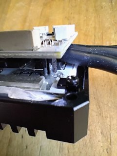

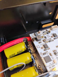

1st & 2nd pic:
Some notable improvements over the 1st gen 75100 alupcb:
Milled pocket above logic pcb for component clearance to case.
Silicone on electrolytic capacitors to prevent vibration fatigue failure.
Adhesive on logic pcb to power pcb connectors.
Battery wires are soldered directly to the bussbars, no pcb trace gap.
Someone must be getting paid by the amount of thermal paste used,
holy cow, there is enough for 5 controllers, better than no paste I guess. (thermal paste is generally thinner=better)

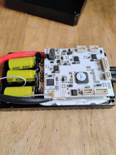

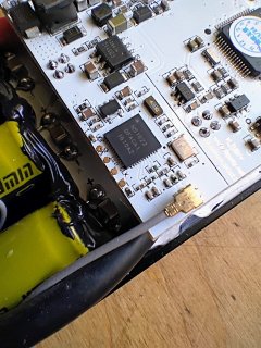

3rd pic:
Well what do have here, I see 4 bare pads marked vcc, gnd, dio, clk, pretty sure that is our bluetooth SWD port,
handy if we need to break out the big guns.
Marking on the bluetooth ic: "N51822" probably an nrf51822 clone.
4th pic:
This end of the power pcb is pressed down by two long legs milled into the top shell.
I am a little concerned about time and vibration wearing through the silkscreen and shorting the DC bus.
When I reassemble, I think a couple layers of kapton tape will suffice.
Far end of the aluminum power pcb is held with screws and metal tabs.

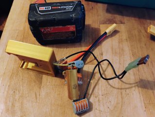

Test rig setup:
3d printed Milwaukee 18v battery adapter.
270 ohm power resistor, 'cuz that's what I had laying around.
5 amp fuse.
Kapton tape can be mechanically damaged if between moving parts; if you add teflon tape with a cloth backer to the top of the kapton, the kapton can do the electrical insulation and the teflon can do the mechanical protection.
