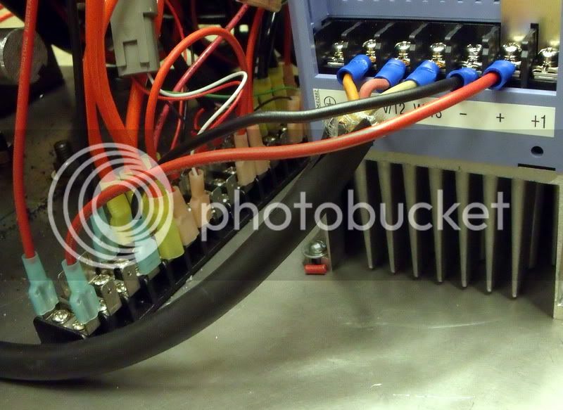

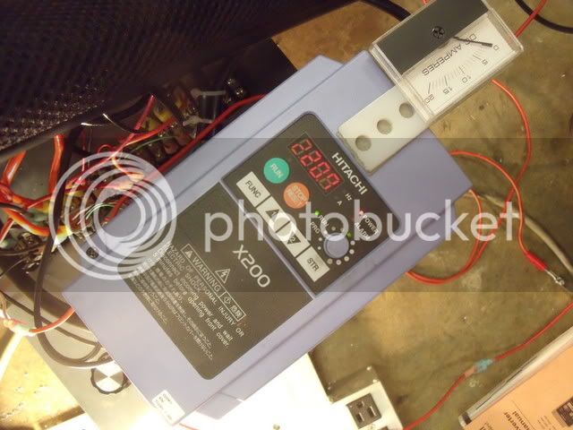

The extra space taken up by the batteries required mounting the motor controller up front. This is a good thing, in that now I can use the built-in speed dial and also have ready access to the stop button (used as a kill switch), and can monitor motor current or frequency just by looking down at the display.
The motor phase wires are connected as before, and I used the batteries in a direct connection to the DC bus to test with the controller (no AC input).
The inverter is connected to the 1-phase AC input terminals on the controller, and it powers up the DC bus to over 250 V when running normally.
I re-installed the shunt resistor on the negative high voltage DC bus, but I may get rid of it as it's giving me shaky readings. Here you can see it with the positive line disconnected.
In fact, the positive line is always disconnected unless I'm driving, for safety. Also, when powering up the controller using the batteries (no inverter power), I use a "sparker" or sacrificial wire to make sure that the controller's inrush doesn't create an internal spark to destroy the switches.
Once the controller's caps are charged, I disconnect the sparker and connect the positive HVDC line to the terminal strip. Here's the overall trike, with the generator-trailer attached.

I have also found a way to monitor the bus voltage using the controller display, which gives me a concept of how the system is working while operating.
