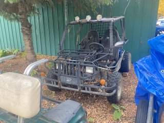

I feel I’m off topic now, but I also have this. My brother won it in a draw and didn’t have the space for it so he gave it to me! Had a ton of fun in it but it’s very janky and something blew up in the driveline. I parked it as I was busy with other things.
Lots of rural gravel backroads around me and trails. Many friends have dirt bikes and ATVs. Always enjoyed driving side-by-sides but despised the emissions and maintenance. I never drive very far but I do rip around and have some fun.
Maybe I’ll start researching this sort of conversion instead. Thinking out loud!
It has roll bars, add a helmet and youth. The sky's the limit. Get a Leaf motor and rip and snort.
