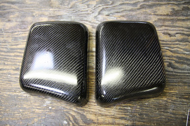

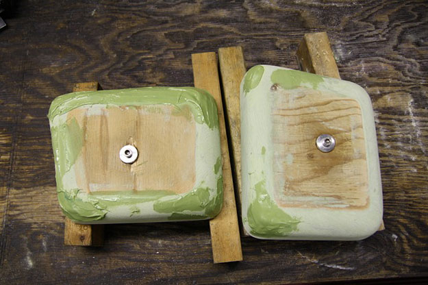

A lot of work went into those, very nice. I have built and am still finishing some carbon fiber and its a crazy amount of work.
Great job!
