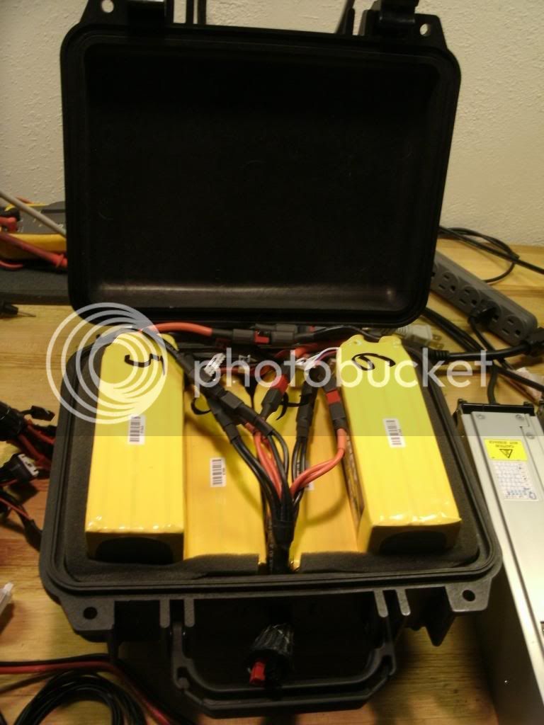

Beachcruzer did a nice job with a pelican 1200 case, fitting 24s2p lipo into a hard-mounted front case. This is 1kw of improved handling. More pics here:
http://www.endless-sphere.com/forums/viewtopic.php?f=3&t=37759&start=45#p634997

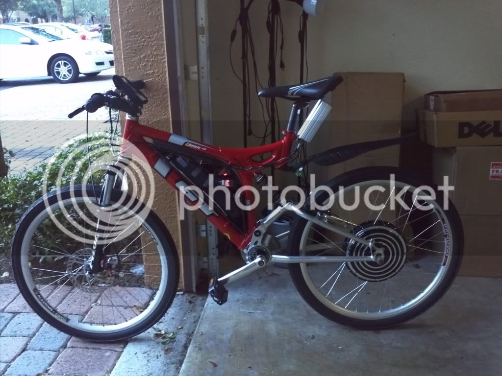

Well, heres my setup people. Loving this ebike thing.
i just made the 50kms club. LOVE IT!!!
its a giant glory 01 (electric glory) im coining that phrase
t has a 9c 2810, 48v 10amp headway pack (upgraded)
to 72 now) and a lyen controller. He is a gun!!! much
appreciated lyen! goes like a rocket. pulling max 50amps
at 115 throttle. can you go 120? im sure some smart cookie
might know. well all the best people and hope it gives
you some ideas. ebikes!!!!!!! ;)

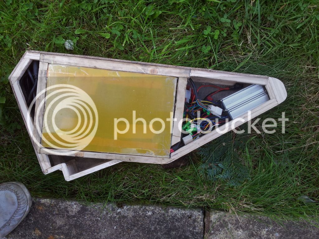

Here's what I've been working on for the past 3 weeks.
Almost ready for paint. Can't decide if I'm gonna rattle can it or have the autobody shop across the street shoot some paint for me. Getting a quote tomorrow.
I still have not figured out how to uploads pics but I made a stupid photo bucket.
http://s1322.photobucket.com/albums/u577/atom1025/Cannondale/
I had a revalate bag on it for a while now. My lipos went south and I can't afford new ones till tax time. I had a bunch of composite making stuff gathering dust and lots of time so I ventured to make a bad ass ride.
Used 1.5" foam. Covered with bondo. Used yellow glass mesh like a chicken wire. More bondo. Followed by 3 layers of the heaviest s-glass Taps plastics had to offer.
Its powered by a mac10 at 57v. Bout 30mph and peaks about 2000w.

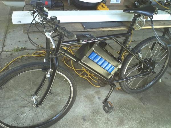

This holds a 52v 9.2ah a123 cellman battery. The side strap opens on a hinge for easy and secure battery removal. I need to add a metal loop that I can hook my ulock through for real security.
Cost about $13 and weighs <2lbs. No welding, just counter sunk the screw heads where necessary.
What kind of metal did you use? And where did you get it so cheaply?

They are easily found in Home Depot (or Lowes). It's galvanized steel, so no rust. About $1-4 for each 'strap'. Look in the lumber section. Much cheaper than the metal stock section. Bend very nicely. It's meant to tie lumbar end-to-end I believe.

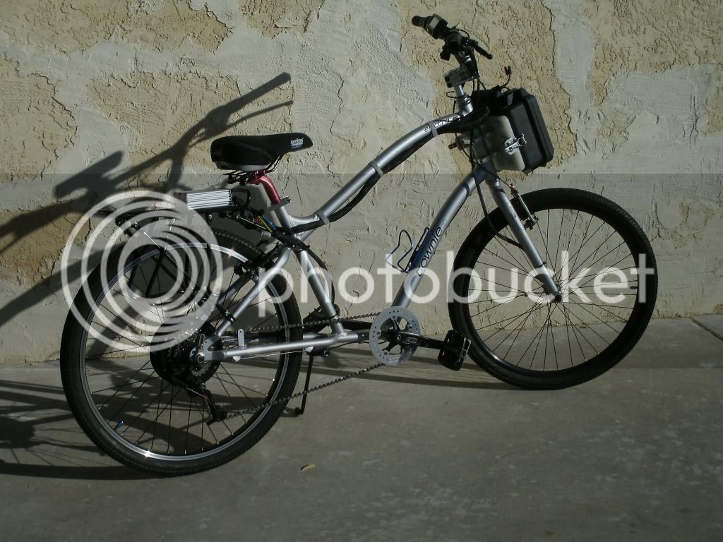

I tried to take a few better pictures of my battery housing. When I started out with this build, I knew that I wanted to use a Pelican case for the batteries. At first, I was thinking that I would mount it in the frame. However, after seeing Oatnet's front-mount setup, I thought it might be a good option for mine. Fortunately, the Electra has an extra-long headtube that is perfect for clamping to. The difference in handling that it makes is astounding. Even before I electrified this bike, the front end didn't feel all that solid when cornering at speed. Now, I'll take turns at 20 mph. It feels like it's on rails. Having the pack mounted to the frame is nice, because I don't feel the additional weight in the steering. It's all in the handling.
I also took a few pictures of the battery pack when it's dismounted. The extra holes in the nylon plate are for vertical adjustability. I figured it wouldn't hurt to have those in case I needed a little more clearance above or below (for cables, lights, and such.) The modular setup is very handy and very secure. The pins have a snug fit, and you have to make sure that the pack is going on square (or it won't slide in place). It has a bit of a "friction fit" that doesn't allow anything to rattle around. I could probably leave the safety latches undone and never have it come off (but better safe than sorry.)
The inside of the case is padded, and the batteries fit in quite snug. When I charge, I check each pack with the CellLog before parallel balance charging. It takes a little extra time to handle all of those connectors, but I figure that an ounce of prevention... Being able to take the pack off the bike gives me a bit more peace of mind, and it is quite convenient for safe charging. If anyone is in the market for a new bike to build, I would highly recommend an Electra Townie. They handle great at speed, and the frame design is very comfortable and spacious. While riding, I never feel like the ride is too rough. I'm having too much fun leaning the bike into turns and giving it throttle on the way out!
Nice work! Looks solid and secure. Where did you get the clamps that attaches the nylon plate to the bike? Or did you make them?
I machined the clamps myself. I was thinking about making a couple extras as it is pretty easy to do multiples once everything is set up. However, I figured that there wouldn't be too many other people that would be doing this same setup. Not many bikes have a super-long head tube like this Townie does. I will soon have CNC capabilities in my shop, too. So, future parts will be even more polished and refined. I'd love to make custom e-bike parts for others. It is a joy to ride this bike, and I'd like to help others get the most out of e-bikes, too. I sure am glad that ES is around. It's a fantastic community.
