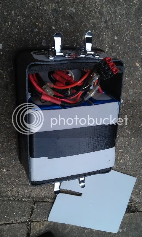

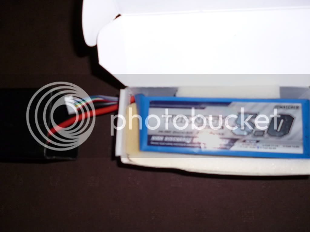

Just found this, So here you go, Drainpipe pringle topper :lol: :lol: ................Not finished yet still got to colour code .
22.2v 10ah, or 44.4 5 ah, going to make two 44.4v 5ah packs quick change :D
Heres the one in the race bike, the last pic is the cover on the bike before the battery housing went in.:

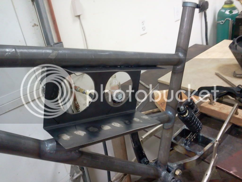

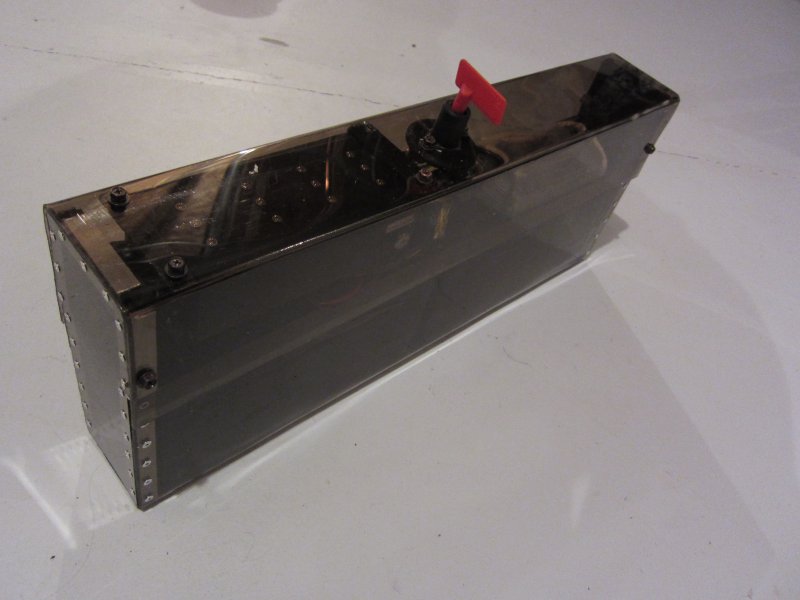

Here's the battery box for my latest build. It is made from hand bent Lexan (polycarbonate) and a bunch of pop rivets. It's about 3.5" x 23" x 9", and feels pretty solid. The controller is mounted to the top of the inside of the box. I still need to figure out where the wires will exit the box. The split pack Ping 48V 20Ah battery weighs about 20lbs, so the brackets on the bike will need to be fairly heavy duty.

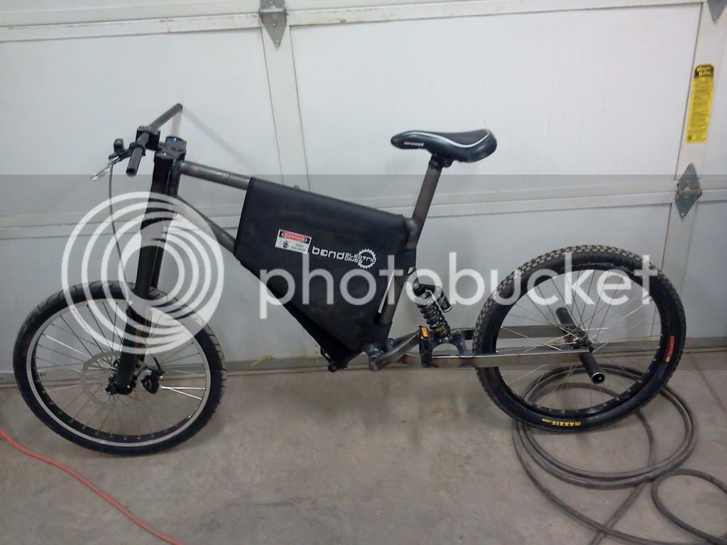

This is my battery bag, custom made for keeping 4 Turnigy 6S 5A batteries in my frame.
For some more info, look here

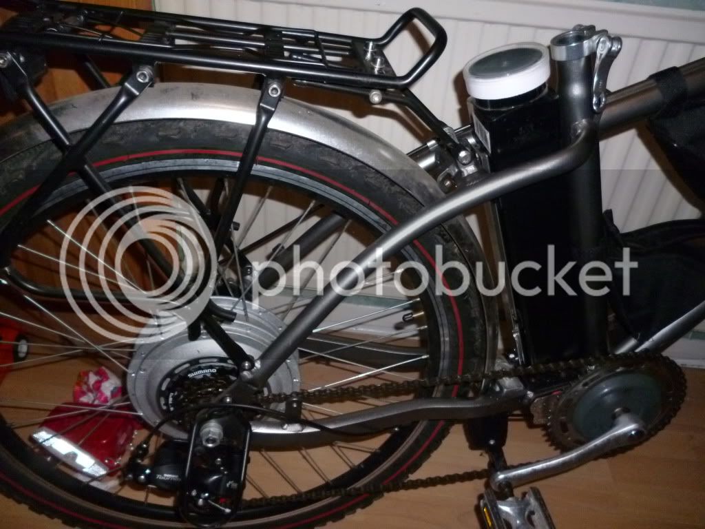

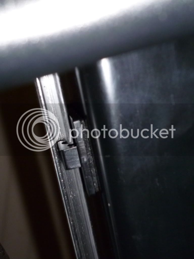

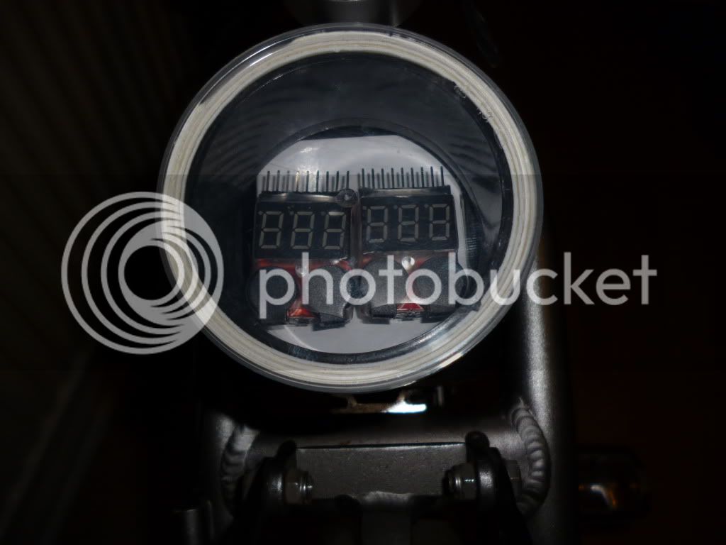

smudger1956 said:
Mine from the 110mm x 55mm PVC ducting, to house 8 x 5s1p 5000mah lipo, 2 steel bars bonded in 'top' with 4 mounting points to make it take off and onable.
Hey that is pretty slick, and it looks like it also serves as your controller mount. I have not seen duct like that before, what was it sourced from?
Anyhow, elegant solution, good use of space. I like how the color is similar to your bike, but I wonder if you painted it flat back, it would 'disappear' to the casual viewer, like the controller does now. Do that, dress the cables a bit, and this would be a totally stealth ride!
-JD
oatnet said:
-JD
Hi oatnet.
The ducting is just classed as 'ventilation ducting', you can get it 'over here' at any decent builders merchant/DIY store/Hardware store, I thinks its pretty universal, I think Hyena used some on one of his builds.
Did not think about using Black for the lipo box, what a good idea that is, that bike will soon be 'de-commissioned'..I have a Kona Coiler to build, everything will go in the frame on that one, and it will all be finished in Satin Black.
Cheers.
Tony.
I think you mean rectangular poly fence rails? Miles of the stuff around your neck of the woods.
