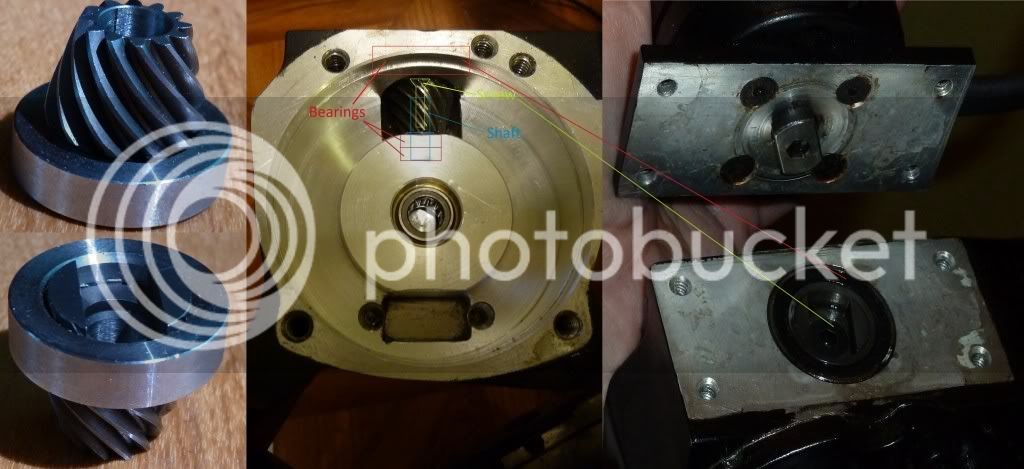

Questions:
1. the rear pulley is attached using the same holes that the disc is? You just ran longer bolts to go through both?
2. What the heck does the small pinion gear look like now? How did you make that part?
3. the new interface with the pinion gear, the bolt head. How did you attach that to the shaft of the motor?
TIA, and again, wow!
Katou
Lets say relatively quiet. I say that because I have seen many builds on ES and I am impressed how quiet hub motors are. Slowly I am thinking about second build with no gearbox, just pulley on motor, rear wheel and polychain belt, but before I start, I have a lot “homework” to do.
To answer your questions:
1. Yes. I just simply removed rivets, drill trough disc brake and 6 arms shimano central lock to fit screw #10. Big pulley has 6 thread’s #10-24.
2 & 3. Maybe this picture bring a little light what I have done here.
From left: It is brand new pinion with metal ring. I just simply replace this ring with bearing. (I had to turn a little bit to bearing in diameter)
The bolt head go inside pinion.
