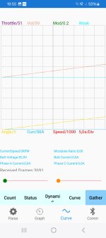

It is so bad now it is not even realistic. It just randomly shuts down without even the throttle burst. I have a video of it happening. I will link it to you after making it. I am writing SiaSysco but not sure if they care. I have done more auto learns with no improvement.
This may be clue.... when this happens, the regenerative braking fails also. I can move no amps, but all other indications look normal.

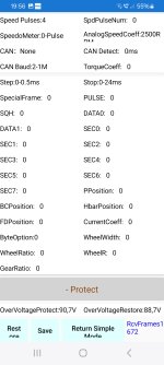

Can I bluetooth to the BMS and controller at same time? The BMS shows me nothing that looks real time. Just settings.
