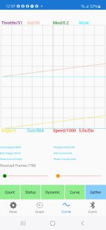

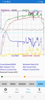

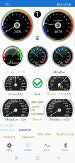

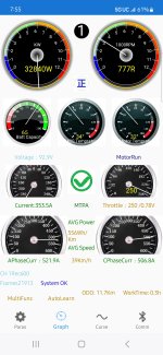

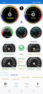

Here are 4 screenshot. One is right before shutoff and next is after shutoff showing throttle still works but nothing happens. After the bike sits for a bit it will go again.
I have screenshots of all my parameters also if that would help. Please help. I love my new bike and want to ride it.

Your throttle voltage is going the wrong way, with 0,78V you have highest power and with 3,8V you have no power.
Or there is a time lag between shown power and throttle, but I have never recognized that myself.
How can you make screentshots with 30kW power or are you running on a dyno?

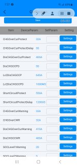

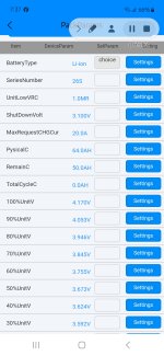

Thanks. Not sure what LVC settings are. Is it something I adjust in parameters? Here is a screen shot of my battery

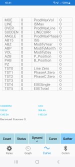

Oh I didn't know that with my awesome Chinese instructions. LOL. Where is the error log?
Sorry, no real log only an error counter.
Curve > count
And this is a Screenshot from the data logging
I have numbers in mine, but no clue what they mean. (Attached)
I think I have some weird setting wrong. Reviewing my videos in slow mo, it shuts down exactly at line amps I set as the limit in "ratios in gears". (Attached). 470 x 75% = 352 Amps.

The errors I had :
MOE was set durig driving without issues but with absolute maximum current settings in the controller , with 10% less everything worked without issues
Over was set when I had the phase wires shorted (over current)
VOL was set after an undervoltage event (BMS cut out)

The errors I had :

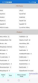

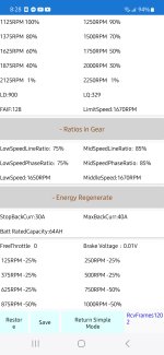

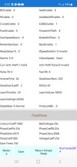

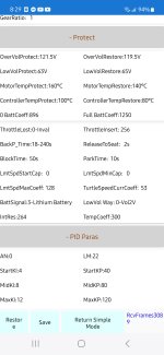

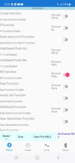

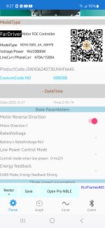

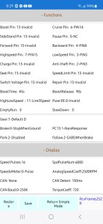

Here you go

Your low voltage value is to low
For a 26S battery set
Low vol 81V
Low vol restore 83V
Sorry thought first you have a 28S battery therefore 86 and 88V would be ok.
I would also change
PC13 to Normal response, otherwhise the controller always activates regen when you close the throttle.
For further testing i would also reduce battery current to
Max line current to 400A
Max boost current to 400A
If everything is then ok start raising currents in steps back to 470A.
It's always better to start with a little lower values and then step up when everything is ok.
I will review this as I have a video of it happening. I am doing a screen recorder with the app up while I drive.
Low vol 81V
Low vol restore 83V
I would also change
So do the 86v and 88v change? It is a 26S battery. And I will make that PC13 change.
With the amp suggestion are saying to raise the ams or lower them? I have it set to max 470 now. I am just limiting it to 352 with the 3 speed switch. I can go to button 2 which is 85% or 400 amps.
I tested it today on button 2 and 3. Both had same failures. I have not reviewed the videos yet but I suspect the motor will die at 400 and 470 amps respectively.
The motor resets bit MUST come to a full stop before it will work again. This must be a clue. It is a few seconds to reset only after coming to a full stop.
81 and 83V
And just to be shure everything is ok, lower line and boost current settings to 400A to try.

I made the Low vol change to 86 and 88? And the 400a max on both line and boost.
It worked perfect in gear 1 as I would never hit 350 Amps. So figured I would try gear 3 and same thing. Shuts down. Except this time everything went to hell. I could not go 10 feet without it shutting off at any power setting. Went back to gear one and no better. The throttle was intermittent and either no go or did burnout like an on off switch and would just shut down in another few feet. Oh and it knew I was in busy traffic. If you are trying to pull out in traffic it WILL shut down. If you are in a quiet neighborhood it does a lot better.

The Screenshot from the "curve" is not very useful, as there is throttle and battery voltage and battery current missing.
The gathered values from "curve" get lost after the controller has been shut down and restarted.
Try to make a Video from the app with the meters displayed while bad things are happening, or even better, a split screen video with the bms app opened also.
